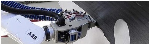

-        Automatic Fiber Placement. For example, Dassault Aviation, EADS Composites Aquitaine or Bombardier Aerospace are using in production robotic workcells provided by Coriolis Composites. Mounted on the robot, the patented end-effector for fiber deposition has been designed to accommodate the limited robot payload. A special fiber guidance system is able to handle the fiber from the creel to the end-effector.
Robotized AFP (Courtesy of Coriolis Composites)

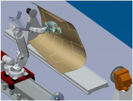

CATFIBER from Coriolis Software, is fully integrated in CATIA Composites Part Design (CPD) and DELMIA, and provides advanced producibility analysis, taking into account material constraints (ex: steering radius analysis) and the machine constraints (ex: minimum tape length, roller crush analysis etc).
CATFiber in DELMIA V6 (courtesy of Coriolis Software)
 Beside the robot programming, it enables to optimize the design of the workpiece, taking into account at the early stage of the design the manufacturing constraints.
