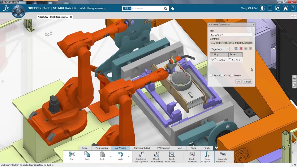

To get the robot program and RRS to pay attention to the weld parameters you entered, you need to create an Arc Operation instead of a Robot Task. Here is the step by step on how to do this.
