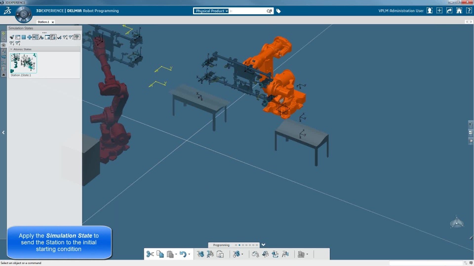

Here is a video that demonstrates how to program 2 robots to work together with IO.
This shows you how to interlock 2 robots for the collision-free execution of 2 parallel robot tasks.
  • Search and Open the Material Handling dataset
  • Create a Tool Profile for a Robot carrying a Grabber
  • Set the Grabber as the EOAT
  • Define a Controller for a Robot + Grabber
  • Create a Robot Task for a Robot + Grabber
  • Define a Grab and Release Activity in a Robot Task
  • Create and Map the IO for the 2 Robots
  • Define the IO in the Robot Tasks
  • Create a Nominal Task to execute the Robot Tasks in parallel
  • Define a collision-free material handling robot station
