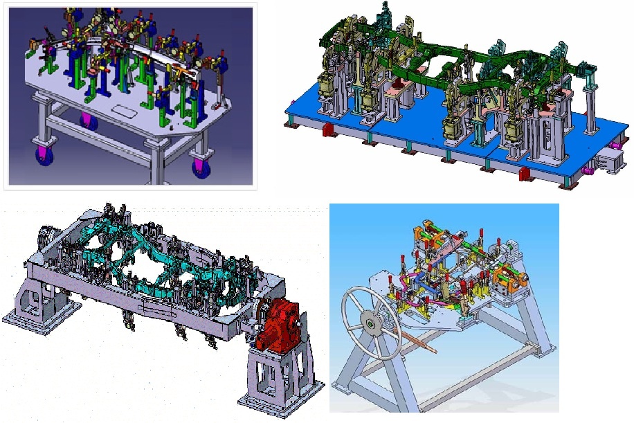

Using this "Assembly Mechanism" feature of DELMIA V6, We can create Assembly Mechanisms of two types.
1. Assembly mechanism with only Sub mechanisms
Some Real time Examples: Stationary Welding Fixtures, Buffer Fixtures and Material Handling Gripper.
2. Assembly mechanism with command joints & sub mechanisms
Some Real time Examples:  Fixtures mounted on Turntable/Trunion, Slides or Transportation systems

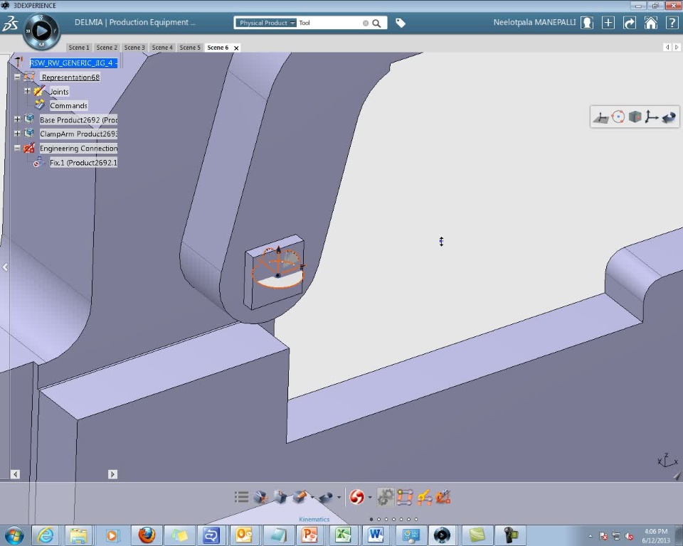

1: Kinematics at sub mechanism level should be defined.
Please refer Creating Sub mechanism Kinematics.AVI given below.

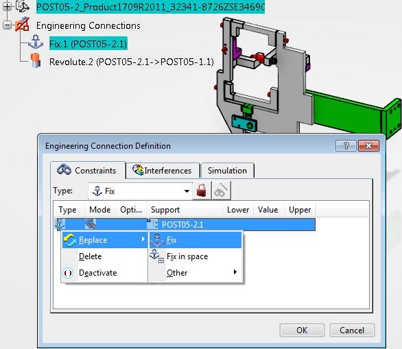

2: Fix type defined for sub mechanisms should be “Fix” (This Prereq is required for Type-2 assembly mechanism)

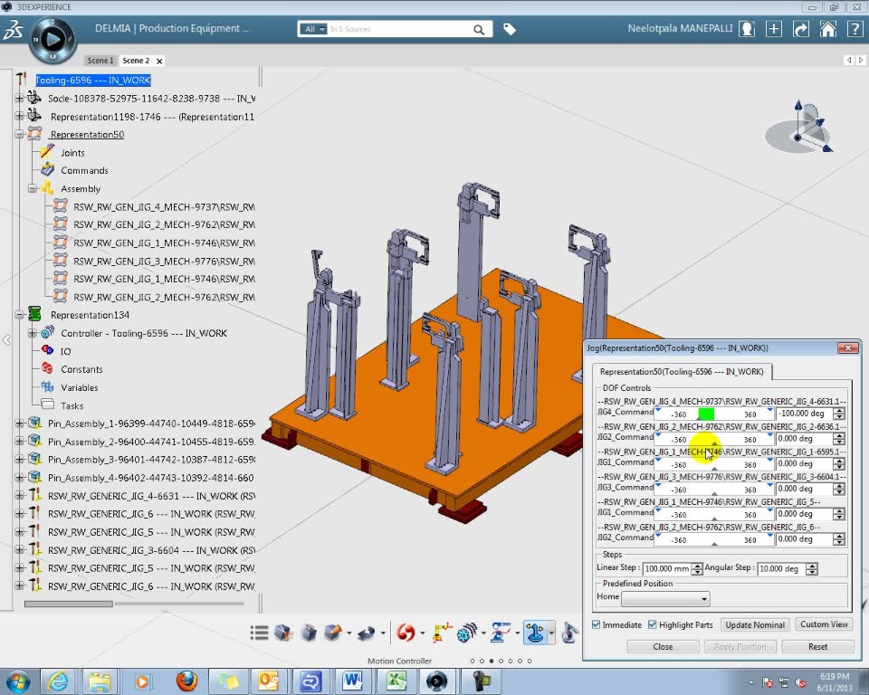

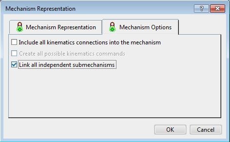

WORKING of TYPE 1 (Assembly mechanism with only Sub mechanisms)
Import and Open Required Tool Device.Data in DBG (Device Building) Apps.
Invoke “Mechanism Representation”  command from “Kinematics” section of Action bar & select root node of Tool Device, activate “Link all independent sub mechanism” option in Mechanism Options tab as shown in image and Select OK.
Structure of Mechanism Representation created under spec tree will be as shown in the image
Invoke “Motion Controller”command from “Motion Controller” section of Action bar and select Root Node of Device. Motion controller for the Device is created and shown under Spec tree.
Invoke JOG , we can see all the individual command joints of sub mechanisms together in one tab.
Please refer Assy Mechanism_TYPE-1.AVI given below

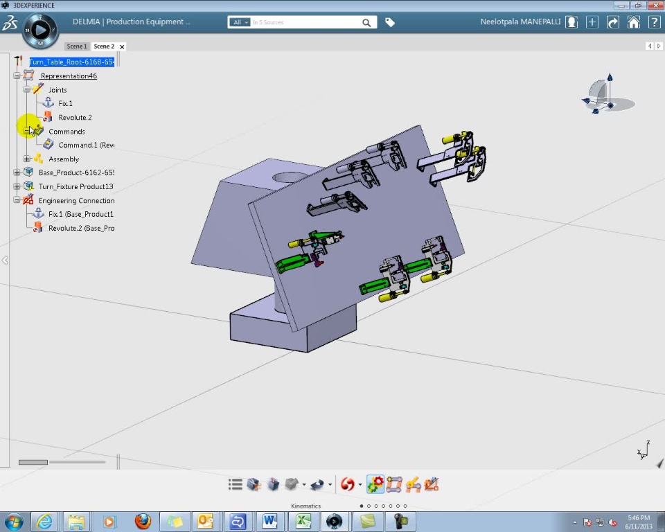

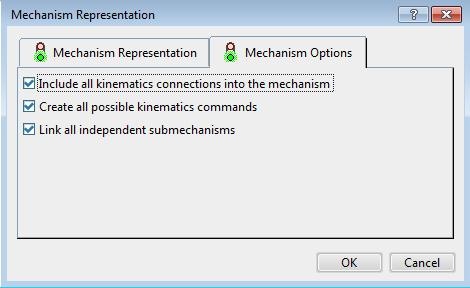

WORKING OF TYPE 2  (Assembly mechanism Command joints & Sub mechanisms)

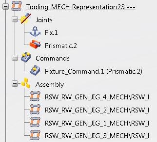

Invoke “Mechanism Representation”  command from “Kinematics” Action bar & select root node of Tool Device, activate options in Mechanism Options tab as shown in image and select OK.
Use “Create Joints and build mechanism”    command for creating command joints at assembly level.
Final Structure of Mechanism Representation created under spec tree will be as shown in the image.
Invoke “Motion Controller”  command from “Motion Controller” Action bar and select Root Node of Device. Motion controller for the Device is created and shown under Spec tree.
Invoke JOG , we can see all the individual command joints of sub mechanisms & command joints created at assembly level together in one tab
Please refer AVI (Assy Mechanism_TYPE-2.AVI)
