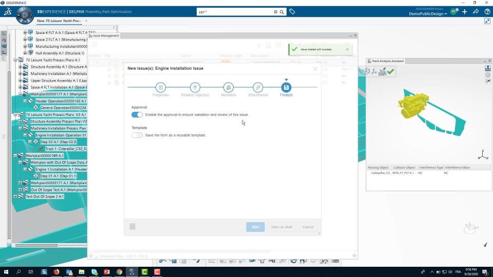

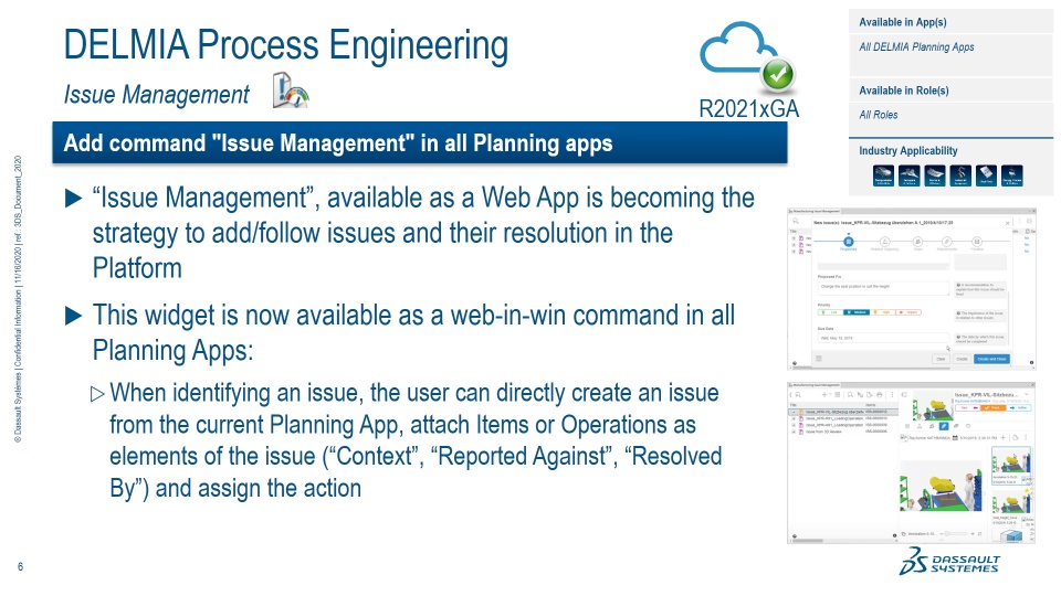

The user is able to create an Issue from any Process Engineering native application with a web in win user interface, perform a 2D snapshot of the current session and annotate it, associate any kind of Manufacturing object (Manufacturing Items, General System, Workplan, Operations, Work Instructions items, Resources...) as Context, Reported Against or Resolved By category.*

Resolve as fast as possible any detected issue during Process Engineering definition phase by leveraging the strategic Issue model to log and describe the problem and collaborate efficiently with all relevant stake holders.
Indeed all collaborative tasks around the issue, such as monitoring, transfer ownership, review content) can be performed within the web user interface (dashboard with ENOVIA Issue widget) without requesting to load anything in the native client.
