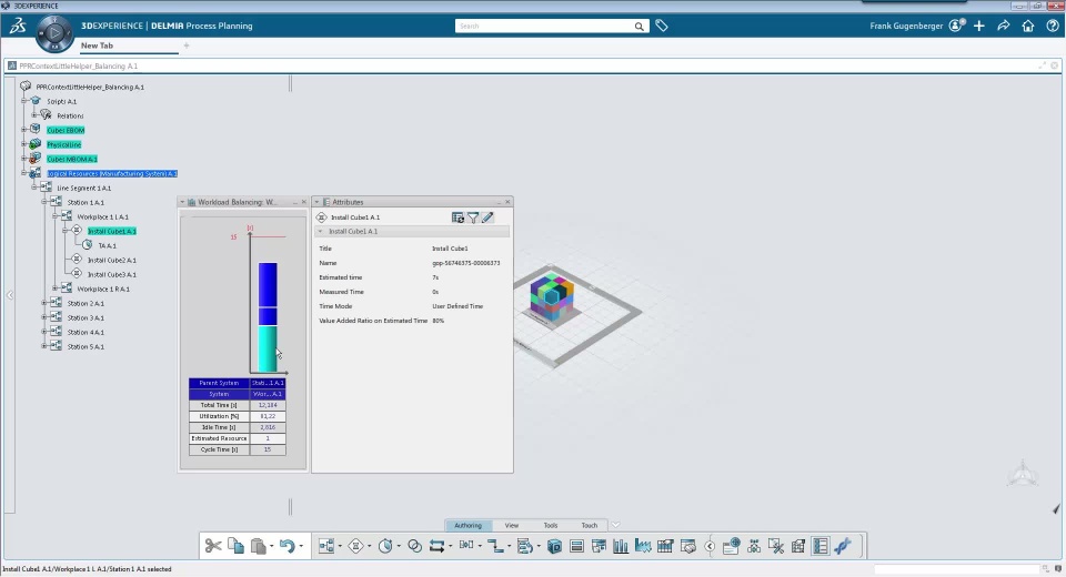

Did you know? We have a Business Logic Rule to manage the effective operation duration to be taken into account in the virtual build-up and balancing.
To illustrate the concept I have attached a video and a script example.
The logic of the script example attached is:
- If an operation has a Time Analysis (TA) , take the time of the analysis (if its greater than 0.0s).
- If it has no TA, look at the value of "Measured Time" and take it if its greater than 0.0 s
- If the operation has neither a TA nor a "Measured Time" > 0.0s, take the estimated time value
- Whatever the duration is to be taken, multiply it finally with a Ratio.
