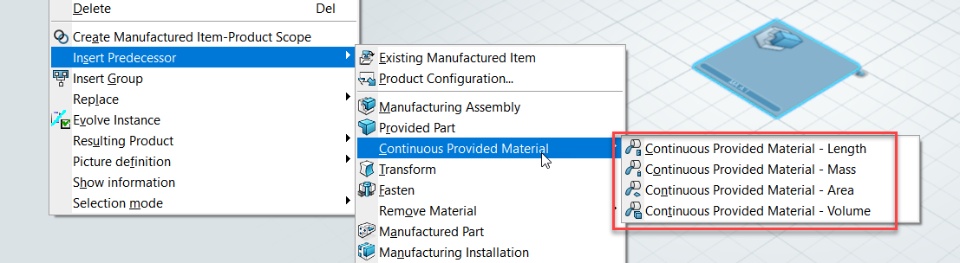

In the Manufacturing Item Structure (conceptual MBOM) of 3DExperience you find several different types of objects, among them items that are used to describe a non-discrete (= continuous) quantity of material.
The quantity can be expressed for material of dimensions (or "magnitudes")
  • Length
  • Mass
  • Area
  • Volume
Please note: The modeling of the quantity is not expressed as a single value.

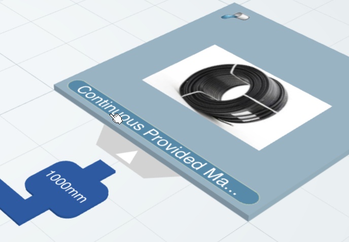

Example: You might want to create a Mfg Item to describe you need 50 mm of a wire. For this you create a Mfg Item of type "Continuous Provided Material - Length"
By default, when you create this, the initial Continuous Quantity is 1m = 1000 mm. (I used the feature to add a 2D Picture for the wire here)

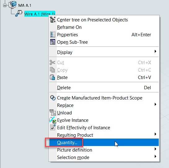

The Continuous Quantity is not changeable by the end user directly (it could be changed via API). What the end user is changing implicitly is the so-called Usage Coefficient. This is happening when the user calls the Quantity command
When you change this from 1000 mm

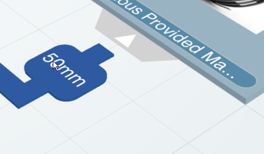

to 50 mm
it will look like this
Internally, the attribute V_UsageContCoeff on ProcessInstanceContinuous has been set to 0.05. This value is multiplied by 1000 mm (attribute V_ContQuantity on ProcessContinuousProvide) to finally come to the product 50mm!

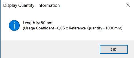

Here is a script example (KW Action) for your reference
/* Script Example by FGB
(Input) Argument myMfgItemOcc is MfgProcessOccurrence
let myMfgItemReferenceCont(ProcessContinuousProvide)
let myMfgItemInstCont(ProcessInstanceContinuous)
let MfgItemExtContLength(DELFmiContQuantity_Length)
/* other possible extensions
let MfgItemExtContMass(DELFmiContQuantity_Mass)
let MfgItemExtContVolume(DELFmiContQuantity_Volume)
let MfgItemExtContArea(DELFmiContQuantity_Area)
let UsageCoeff(Real)
let ContQty(LENGTH)
let myLength(LENGTH)
set myMfgItemReferenceCont = myMfgItemOcc.Reference
if ( myMfgItemReferenceCont <> NULL)
set myMfgItemInstCont = myMfgItemOcc.Instance
set MfgItemExtContLength = myMfgItemReferenceCont
if ( myMfgItemInstCont <> NULL and myMfgItemReferenceCont <> NULL)
UsageCoeff = myMfgItemInstCont.V_UsageContCoeff
ContQty = MfgItemExtContLength.V_ContQuantity
myLength = UsageCoeff * ContQty
PopupMessage("Length is: # |(Usage Coefficient=# x Reference Quantity=#)", myLength, UsageCoeff, ContQty)
