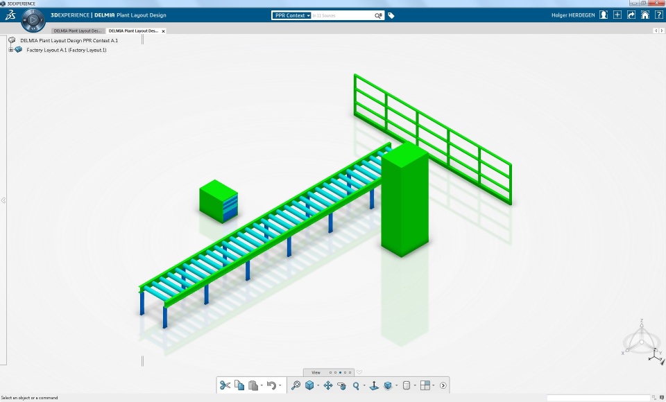

Hello,
I entered in the wiki some tips how to distribute and align resources during layout planning with DELMIA in 3DEXPERIENCE. The examples are created with R2015x.
How to duplicate a resource multiple times:
How to align resources (for example same floor height or along a direction):
How to distribute resources (specific distance along a direction or contact):
How to rotate resource to match the orientation of another resource:
I attached two sample layouts for own experiences:
