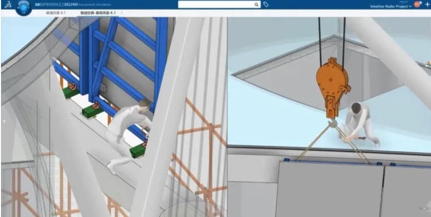

Simulation before construction
The ability to refine the design of the weather tower and simulate how it would be constructed in the virtual world has helped to remove any unknowns from the construction stage. This has saved CSADI time and money.
“We used DELMIA to create a virtual twin and simulate the construction process and automated equipment,” Zhang Shen said. “This allowed us to test and verify everything before construction to ensure that all work orders were clear and the process was foolproof.”
These simulations have been critical for ensuring worker safety during construction too.
“One aspect we simulated was the hoisting of the facade components in the installation sequence,” Yang Hao explained. “The simulation took into account specific scenarios including the location of suspended platforms, obstructions and wind calculations, helping to determine the ideal conditions for workers to safely install the facade.”
