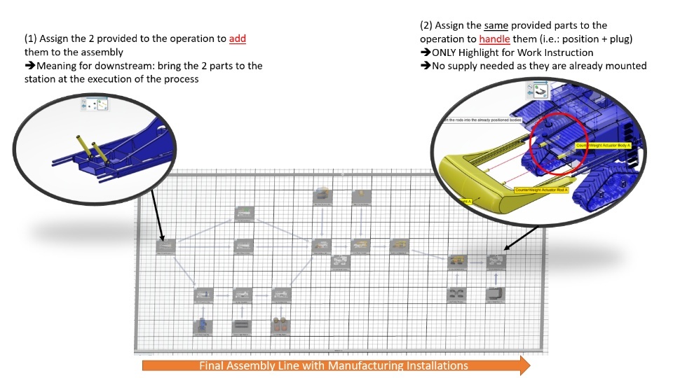

Here is a concrete example from a customer:
First workplan to add the parts to the assembly, last workplan (in case of Manufacturing Installation), manipulate the same parts to plug them without triggering the supply​​​​​​​

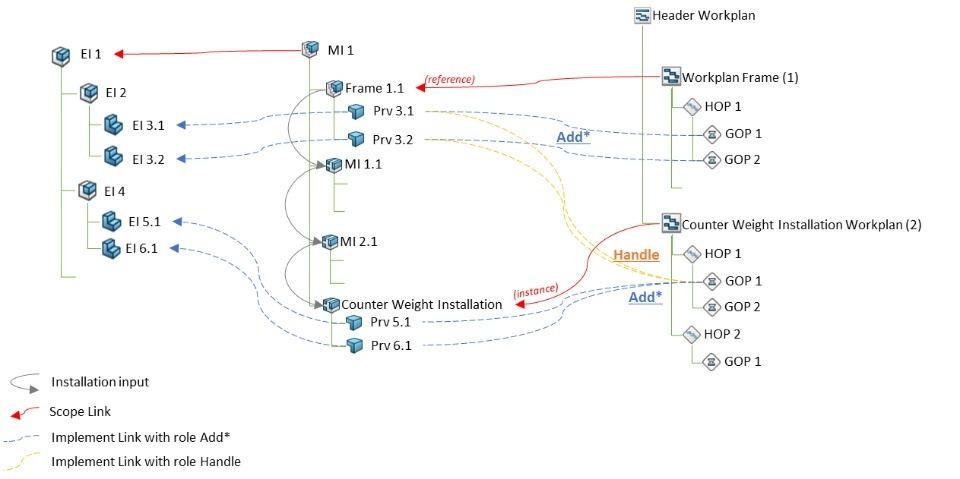

Data model used for this example:

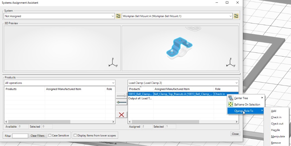

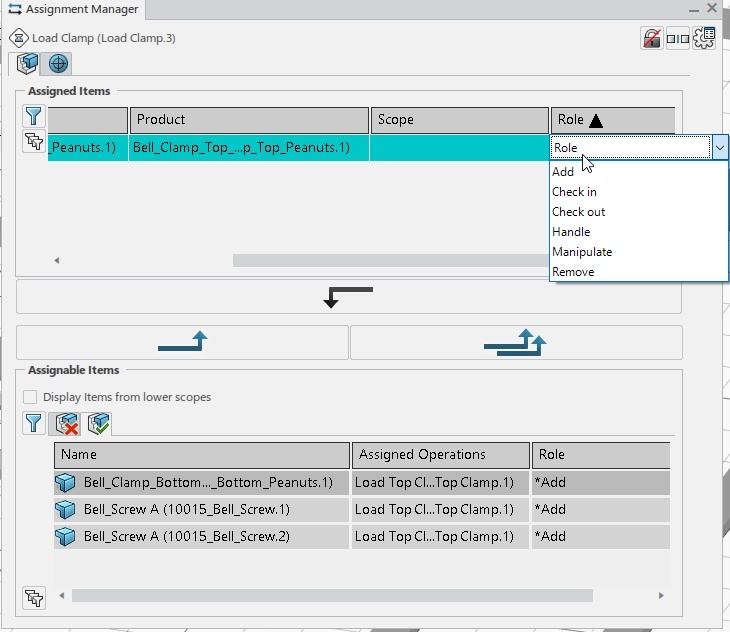

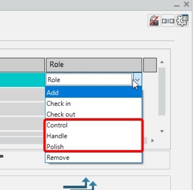

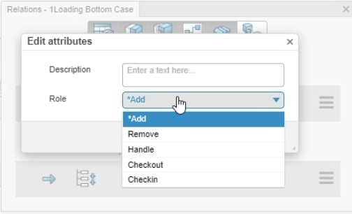

How to edit the Role
On PPL
Assignment Manager
Dedicated column with a dropdown list. It includes the custom roles too.
System Assignment Assistant
Dedicated column with a contextual menu. It includes the custom roles too.

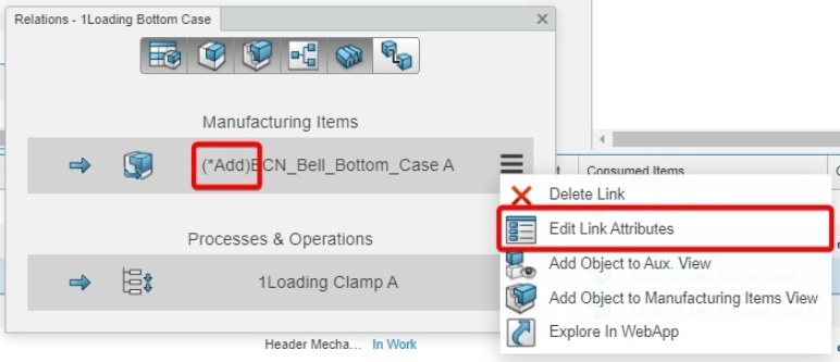

On MGA​​​​​​/RME
With the function "Relations" and its contextual menu.

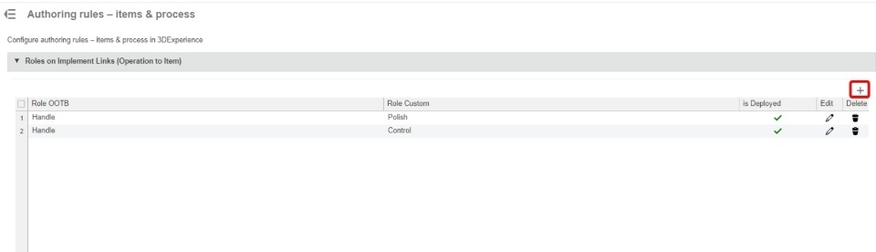

Customization
Sub-Role creation
Depending on the customer needr, it is possible to create a sub-role of the OOTB ones (available on Cloud from 23xFD01, applicable on MGA from 23xFD03), which will inherit the semantic and behavior from the OOTB Role.
Prerequisites: VPLMAdmin role
Action possible:
- Create new role (as sub-role of OOTB role)
- Update Role (Name and parent OOTB Role)
- Delete Role

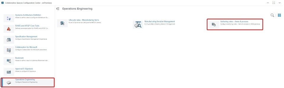

Widget:
Screen:
Open Operation Engineering menu > Authoring rules - Items & process
Click on + to create new role
The created role will be added in the list:
