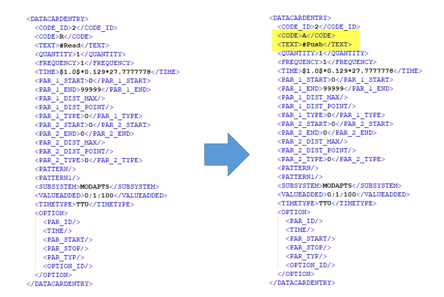

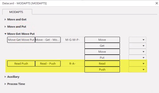

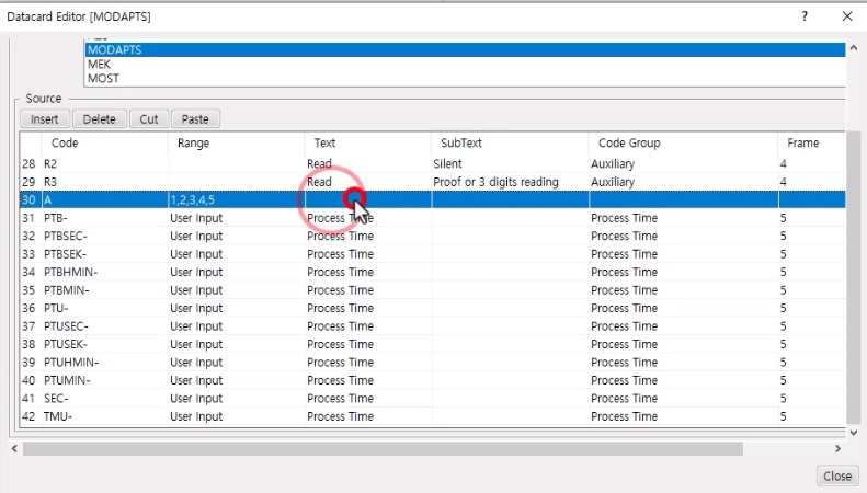

We can input additional codes and combinations of codes in MODAPTS time anlalysis.

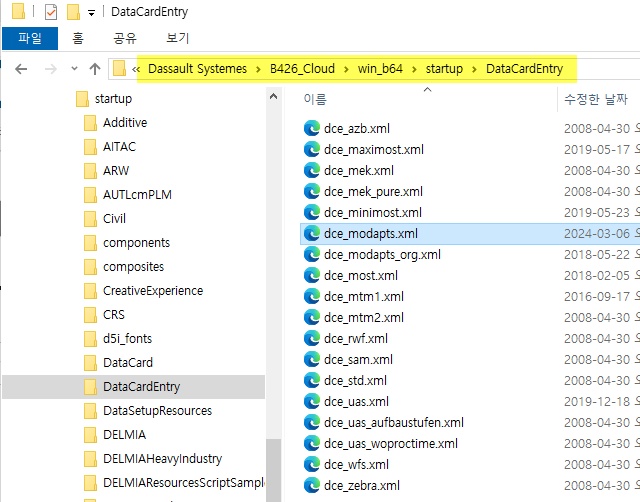

We can do this by modifying "dce_modapts.xml" and Datacard Administration .
The file "dce_modapts.xml" is in "Installation folder\\win_b64\\startup\\DataCardEntry"
To add the new code, copy & paste the existing DATACARDENTRY in dce_modapts.xml, and then modify it. Here A- code is added.
Now we can input the new codes.

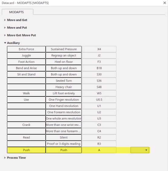

We can make it visible in Datacard by "Datacard Administration". Or we can also do this by modifying files, "dc_MODAPTS.xml" and "dcg_MODAPTS.xml" in "Installation folder\\win_b64\\startup\\DataCard".

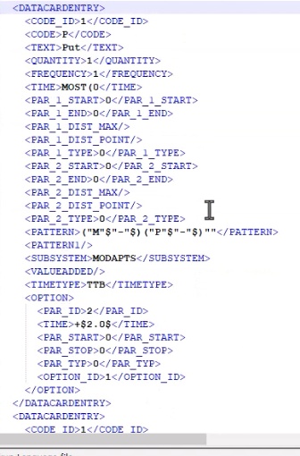

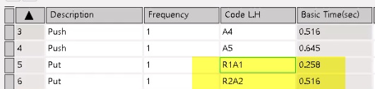

We can also input the new combinations of codes.

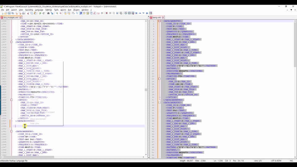

Copy & paste the existing DATACARDENTRY set for the combination, and then modify it.
Then we can input the new combination of codes.
Also we can make it visibel in Datacard, if we want.
Please, refer to the below video for the detail steps.
Thank you.
