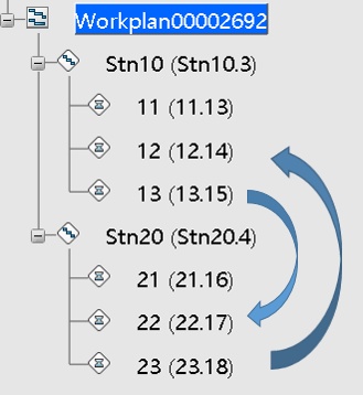

Sometimes we want to rearrange the sequence of operations easily by drag & drop without Tree Reordering and we also want the Product Flow to be redefined automatically as the modified Tree order.

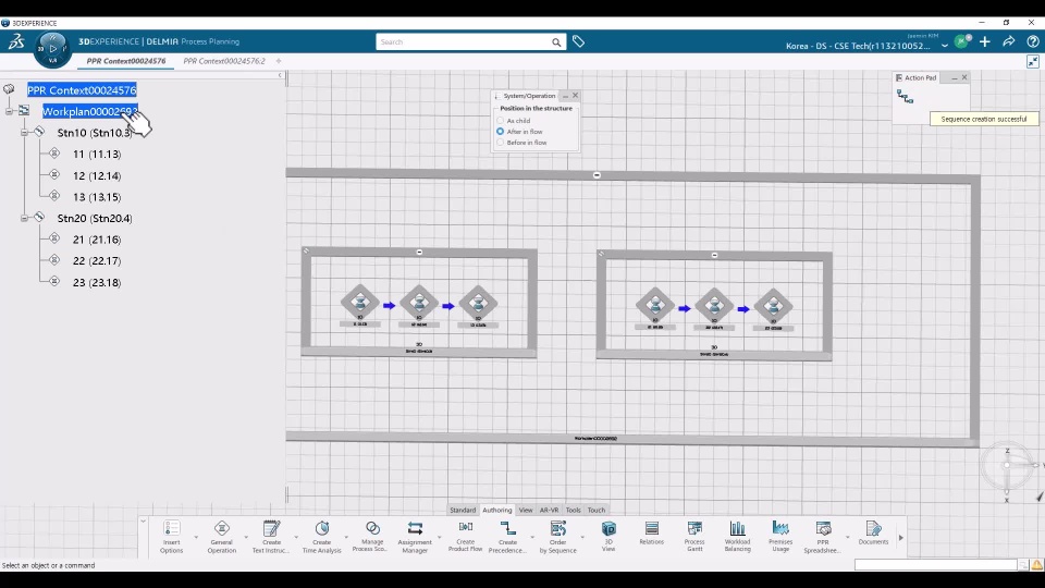

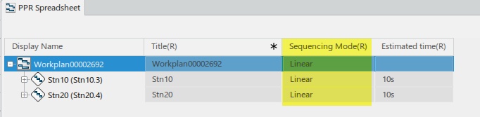

To do this, we can use the features "Insert Options" and the attribute, "Sequencing mode"
Please, refer to the below video.
