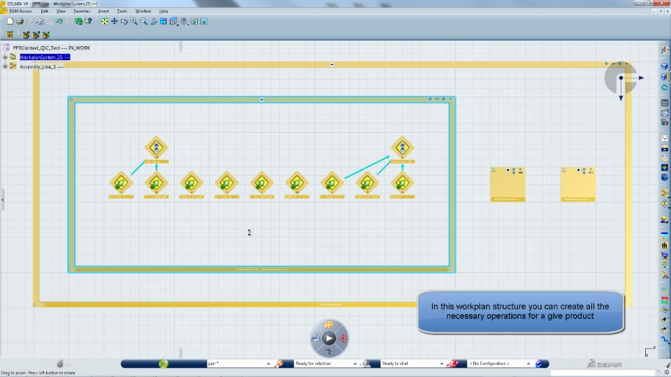

1st one: Workplan system structure allows the process planner to create, organize and detail all the operations required to build a given product

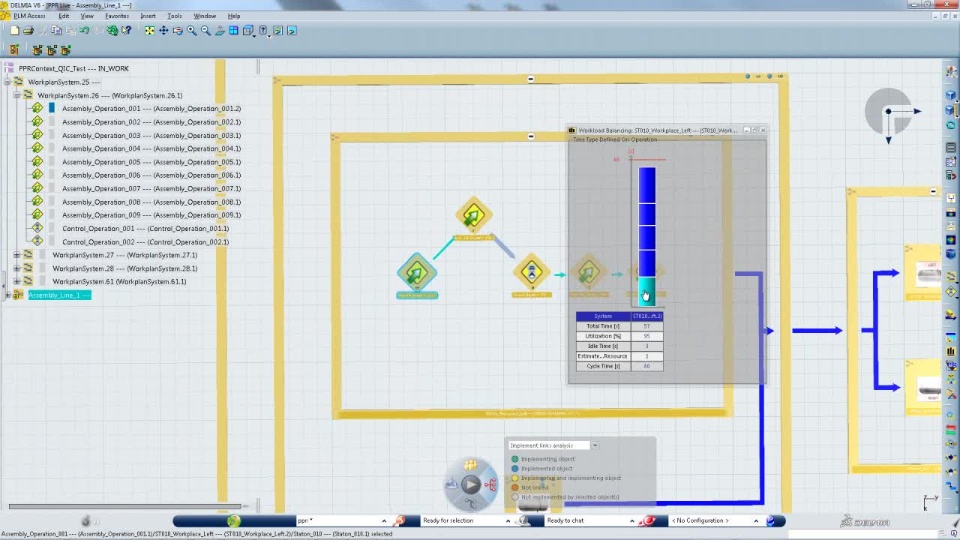

2nd one: Line/Station/Workplace system structure will allow the manufacturing engineer to balance all the previously specified operations across the production line
Important: There is no duplication of the data between workplan and line system structures. You will have 2 instances of the same operation reference and an implement link between them.
You will take benefit from the model of scopes and implement links between structures to easily identify what is already assigned, what has to be assigned and what has to be updated (the management of inconsistent link functionality will also support this new approach)

Automatic balancing
Once the planning has been specified by the process planner in the workplan structure, the manufacturing engineer in charge of the balancing will be able to use the work of the process planner as input specification for his work.
For this he has two options:
- Full manual balancing:
- Automatic balancing which can be combined with manual balancing as well
This new functionality of automatic balancing has to be used with a workplan structure as input and line/station system structure as target.

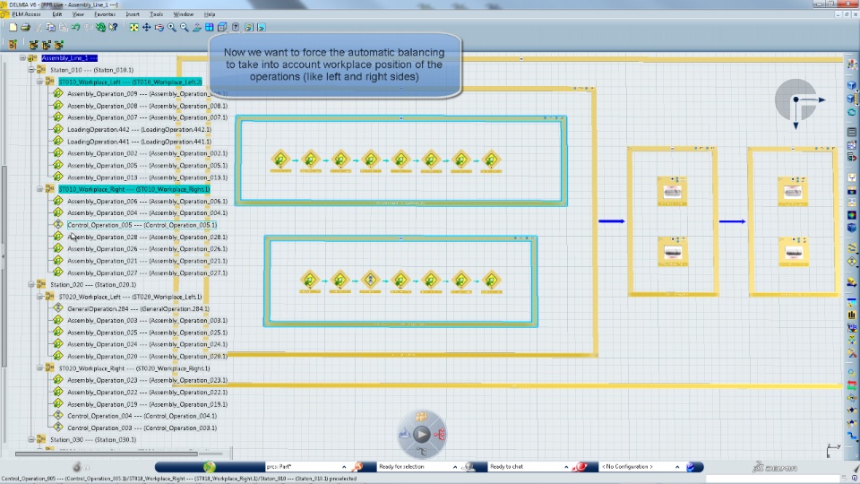

Some business rules have been added to enable some customization for balancing constraints like workplace position specification on the operations (see the example in the video at the end)
