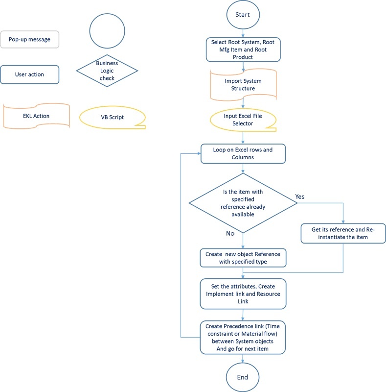

Logical Flow
Below is the logical flow for Import System Structure EKL script:

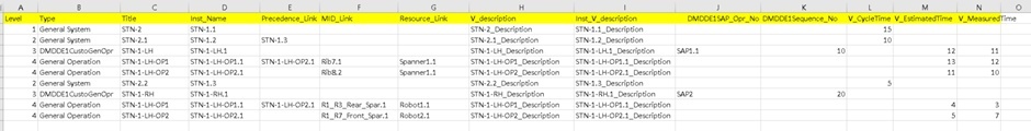

Excel template for Importing Resource Structure
The template excel format is as shows below:
The 1st 7 columns are reserved and necessary to be added. Their description is as given below:

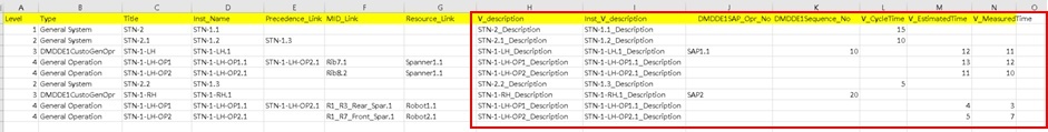

Additional attributes
All other attributes (Internal name) to be set on created Object’s reference and instance.
Note: If instance attributes value needs to be set then add “Inst_” keyword before attribute name. For example for instance description, it will be “Inst_V_description”

How to set additional attribute and other custom attributes:
To set other extra attributes of the created objects, add extra columns in the excel file after column 7. 1st 7 columns are reserved for Level, Object type, Title(Reference Name), Instance name, Precedence link, MID Link and Resource link. While creating the column, column name should be the attribute name. Add the values in respective rows. While setting the column name for attribute of instance object, add “Inst_” as a prefix in the column name.
The EKL script manages to set the additional attributes if they are specified in the excel file. The condition is, the attribute should be available on the object. User can specify custom attributes also if available.
For example: Additional attributes to be set are highlighted in red box.
The code between below comment lines in attached EKL script is responsible for setting additional and custom attributes. It set both reference and instance object attributes.
//Logic to read remaining columns and set additional attributes
//End of for loop to set Additional Attributes

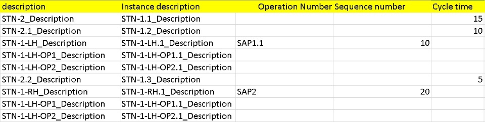

3. Requirement 3: Use custom column names instead of internal attribute name
If the user wants to use custom column names instead of internal attribute name, for example:
Here “description” is used instead of “V_description”
Add below line of code in the EKL script, where additional/custom attribute values are read from the excel file.
if strAttrName== " description "
   strAttrName = "V_ description”
else if strAttrName == "Instance description"
   strAttrName = "Inst_V_description"
