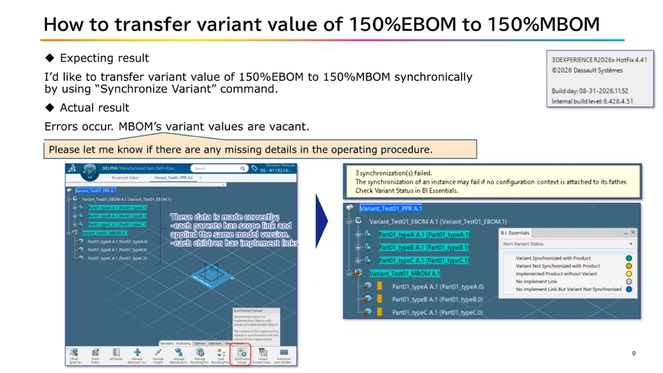

Hello, I try to make 150%PPR and make MBOM easily at first.
I couldn't find the method to transfer variant value of 150%EBOM to 150%MBOM, so please let me know it.
Question
How to transfer variant value of 150%EBOM to 150%MBOM synchronically?
I'd like to make same setting EBOM product and MBOM item which are linked by implement links.
Scenario
1) Define model version and variant value.
2) EBOM's objects is applied the configuration (model version and variant values).
3) Make MBOM's top with the scope link to EBOM's top and model version setting.
4) Do the command of "Create Mfg Items Structure", make MBOM's Items with implement links.
5) Variant values are vacant.
If I do the command of "Synchronize Variant” command" on native app, errors occur.
