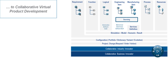

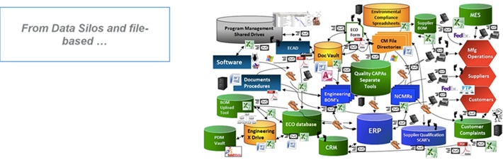

During our various customer engagements, we saw that many of our customers and prospects are still suffering from working in data silos, and there are numerous file-based integrations between various business systems. Our mission and opportunity is to help them transition to working within a Value Network, leveraging the Virtual Twin Experience thanks to a highly integrated and intertwined data model that spans across the full range of disciplines supported by the 3DEXPERIENCE Platform.

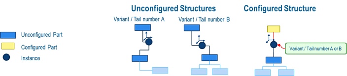

Configuration management functionality enables you to define variation within a product without completely duplicating the entire product structure. You only create additional content for those items related to the specific “variant” of the product you are focusing on. In addition, as the product definition evolves over time, Configuration management functionality enables you to incrementally update the product structure and trace the changes introduced at specific points in time or “evolution”.

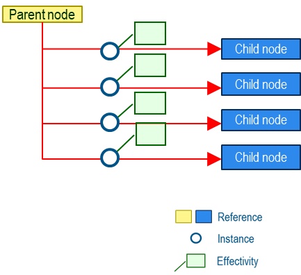

One key concept to understand before we go further is the notion of a “Configured Structure”.
A Configured structure is:
- Any Data Structure (system, engineering, manufacturing…) where we define an effectivity on the instance between the parent node and the child node.
- The effectivity is a logical expression (including operators like AND, OR, NOT, …) using the elements from the Configuration Dictionary and defining under which condition a child belongs to a given configuration
- When filtering the structure, child nodes will be displayed only if the elements from the Configuration dictionary that have been selected in the filter criteria are validated in the effectivity logical expression
When we talk about EBOM or MBOM at 150%, we mean that such structures are configured structures that are not being filtered. A “100%” structure is a configured structure which is being filtered to produce a precise result.

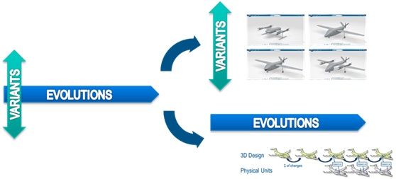

We also identify two axes for Configuration Management:
- Evolution: related to changes which occur over “time”, where the units of time may literally be based on calendar dates, or may be based on discrete units produced or based on milestones.
- Variant: used to define diversity within the product definition, typically to address varying customer demands for functional content within the product.
Example:
- The content of a Configured Structure may vary based on some combination of diversity of “Variant” criteria, as well as based on some ongoing change activity over time or “Evolution”.
- A Car may have a “basic” or “deluxe” Configuration where certain parts also evolve over time based on design improvements which are introduced periodically.

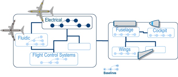

Based on the previous definitions, we can use a modular approach. To understand let’s consider an aircraft as a system of systems. A system would be called a module and each system manages its own baselines through a tree. All interfaces between these systems are identified.
