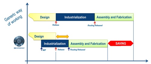

Comparing the Generic/Classic way of working with the concurrent engineering approach, we have identified that most of the savings are related to the release process. Thanks to the collaborative work on the platform, we can anticipate significant industrialization feedback to engineering at the "IN WORK" state (design in progress). The engineering team can immediately introduce the modifications and release a product that will have less risks of being modified.
With some customers, they have achieved 40% less in number of modification and around 30% on lead-time reduction.

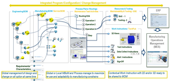

MBOM & Process
The Manufacturing Bill of Material (MBOM) or Manufacturing Item Structure (MIS) represents the Components and BOM structure of the Product to be manufactured. It is a fundamental input to production as well as ERP, primarily to drive the procurement process/sourcing process.
Within Digital Manufacturing, the MBOM represents the input for Process definition and provides the link to 3D visualization, including potential use within 3D Model-based Work Instructions, as well as within the family of DELMIA Simulation-based applications.
Process Plan definition contains the detailed list of operations and steps that have to be executed to build a finished or a semi-finished product. In the Process Plan definition, we also set operation times, required tools and components for each operation as well as the corresponding Work Instructions (Text Instructions, Data Collect Plans, Alerts and Sign Offs) for the operators. The Process Plan is mandatory to generate a Work Order in the ERP as well as to publish instructions to the shop floor (in our MOM (APRISO) solution) where they are performed.

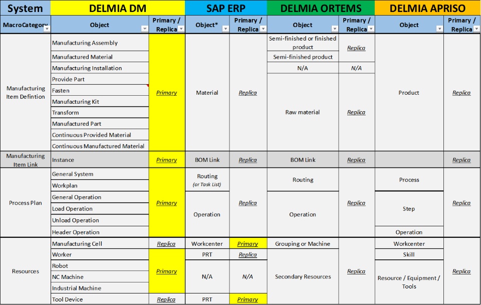

At this stage, it is important to have a clear understanding of what system is the master of what data and why. Here under is our recommendation for master data management (Primary/Replica Matrix):

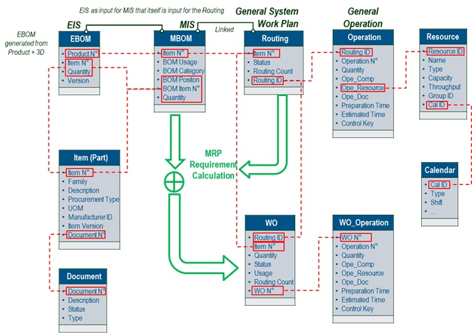

With all the information presented, we can see now a NON-exhaustive mapping of the minimal attributes to be managed for each object and their relations. This mapping is an example of what are the relations between the objects in the different applications (DELMIA DM, APRISO, ORTEMS, ERP):
