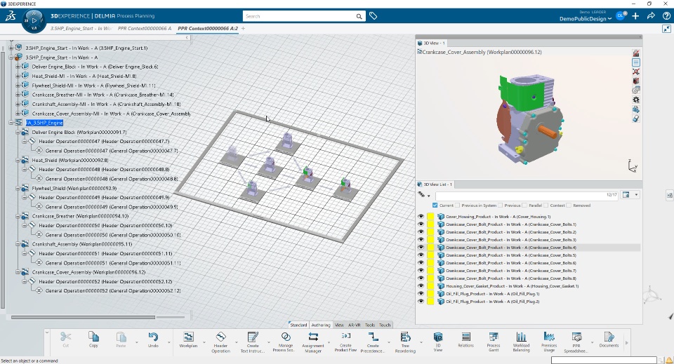

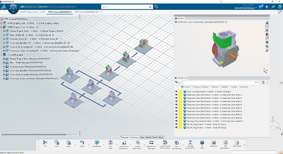

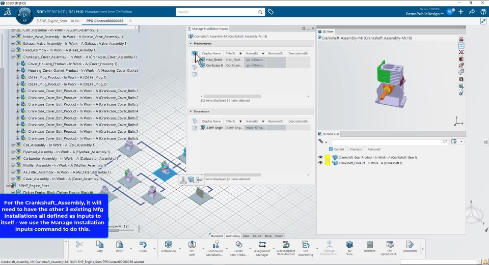

  • Within the annotated ~15-minute demo video (annotated with callouts) you will see how to create and adjust a sequence of Mfg Installations starting from scratch, and then how to use this MBOM content to define a set of scoped Workplans for basic Process Planning of the Final Assembly process.
