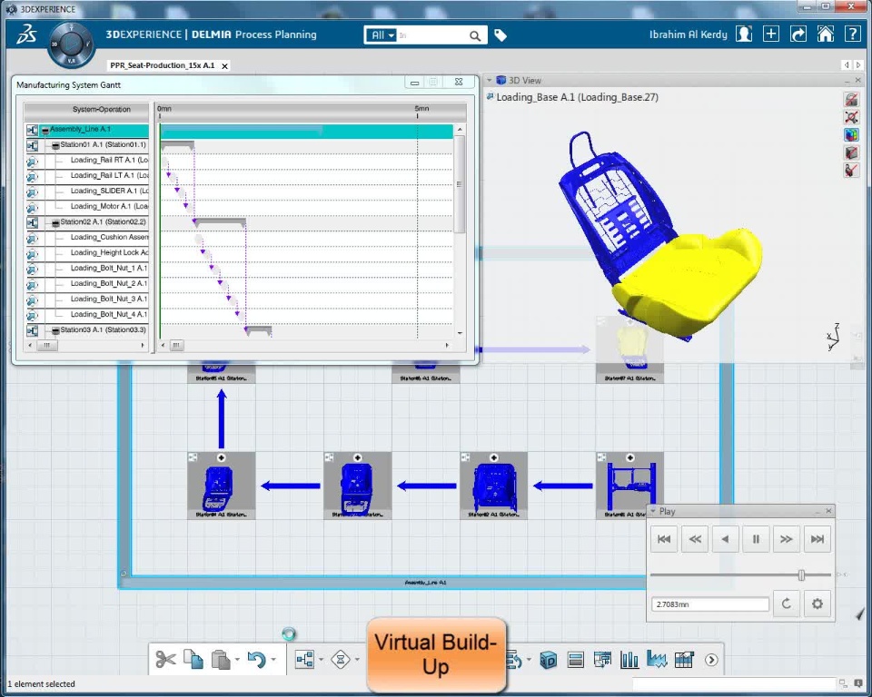

 DELMIA 15x video: automotive seat final assembly line.
Main steps in the video:
- Review the product (EBOM) in 3D
- Create the MBOM, the Routings (Operations Gantt), perform Line Balancing and Virtual Build with DELMIA PPL
- Review the 2D (imported DXF) and 3D Layout (workers, machines...from the DELMIA catalog) thanks to DELMIA PLA
- Balance the Operations to the Workers (PPL)
- Virtual Build-Up in 3D context (complete line)
- Replay  the Assembly tracks created with DELMIA MAE
- Robotic Arc welding simulation and OLP with DELMIA RAR
- Ergonomic Study thanks to DELMIA EWK
- Discrete Event Simulation with DELMIA IEN
