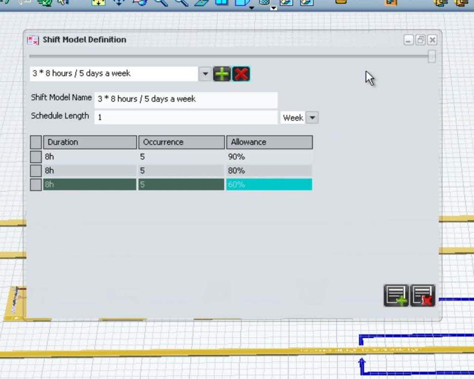

- Define shift model ( number of hours worked during one periode, with associated occurences and allowance)
With a combination of these two input parameters applied on one manufacturing planning dataset(process and manufacturing sytem structure with balanced operations), the system can automatically compute the takt time and use it for workload balancing purpose.
So in the workload balancing interface in MSD you can now use the functionality Premises usage to check several combination production demands and shift models to compute the takt time, optimize the workload balancing and eventually set the default cycle time based based on computed takt time.
