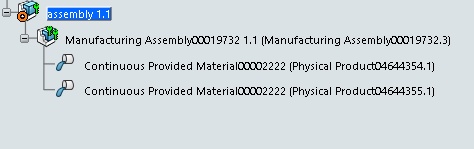

We have a big question in our project regarding the use of continuous provided materials. It seems to work fine for our cases, but we run in a problem in our test session which is worrying us.
Scenario:
1. create a manufacturing structure containing 2 instances of the same reference of continuous material
2. try to drag and drop those one by one in a different place in the manufacturing tree

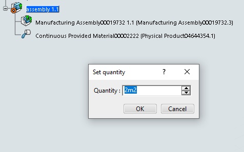

3. Result: those 2 instances will be merged under the same instance and the usage coefficient will be added
Any explanation of why this is behaving like that?
