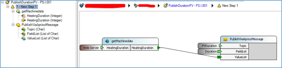

  2. “Apriso Message” Function to “Publish” the values coming in from machine via OPC layer; an example below:

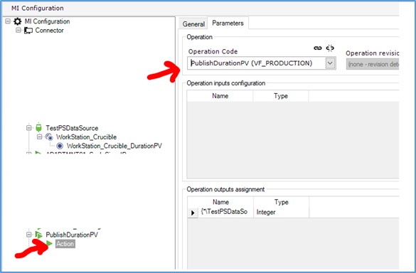

  • Above SO gets called from MI, on point value change

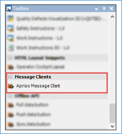

3. Finally, subscribe to the topic in order to receive and display the data (refer for Apriso Message Bus Implementation guide for more details)
