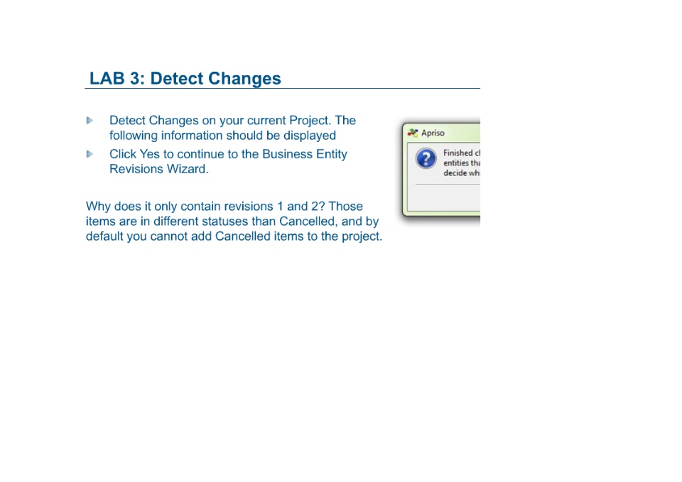

The lab asks me to make some changes in Process Builder and then detect changes.There is no “Detect Changes” command in Process Builder.There is a “Detect Changes” command in “Global Process Manager”. This detected no changes.
Answer:
The slide which tells to detect changes should have information that this is to be done in GPM. The Detect changes is in GPM003 module, Chapter 2 (Lab 3), not in Process Builder.We will improve the instructions in the next version.
