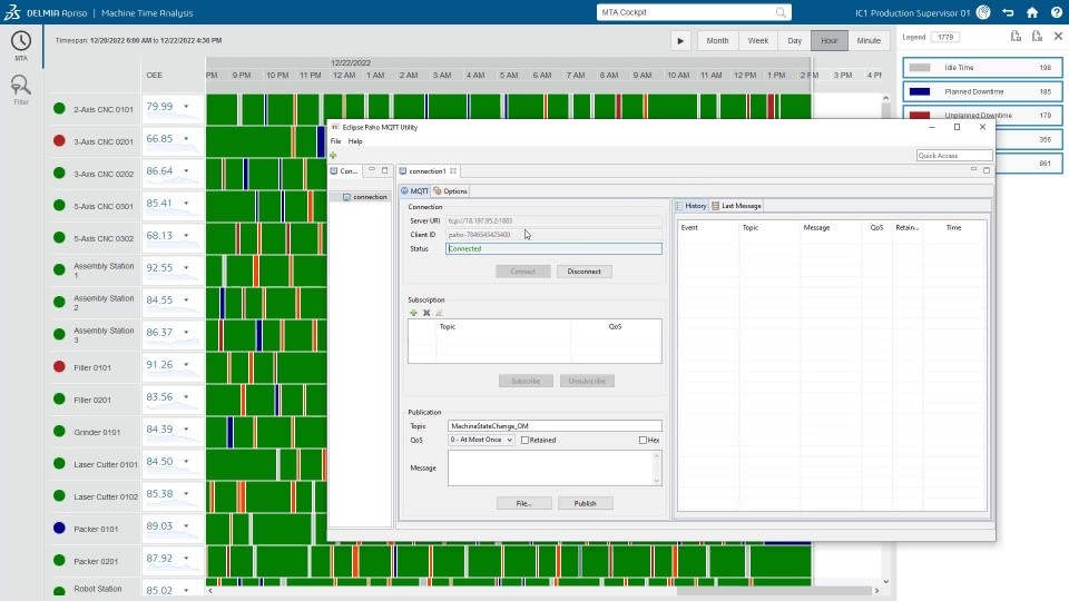

In the below narrated video, we have configured MQTT to work with DELMIA Apriso Machine Time Anaysis (MTA) screen. MQTT broker is the online HiveMQ test broker (http://www.mqtt-dashboard.com/) which can be accessed with our Experience Center servers.
We are updating the Machine Status through MQTT which can be seen in Machine Time Analysis screen. To publish the message from MQTT Client, we are using Paho MQTT Client.
At the end, we are also publishing message from DELMIA Apriso Standard Operation to HiveMQ test broker. To subscribe to Apriso published messages, we have used the HiveMQ MQTT Client available online.
