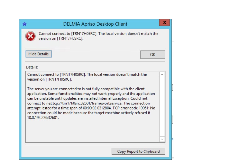

​​​​​​​Question:
I can´t connect to APRISO Desktop Client. I used to receive this message, but generally after some tries I can connect. But this time, I couldn't.
Answer:
If you have this issue again, try uninstalling the Apriso Desktop Client, and install it again.
