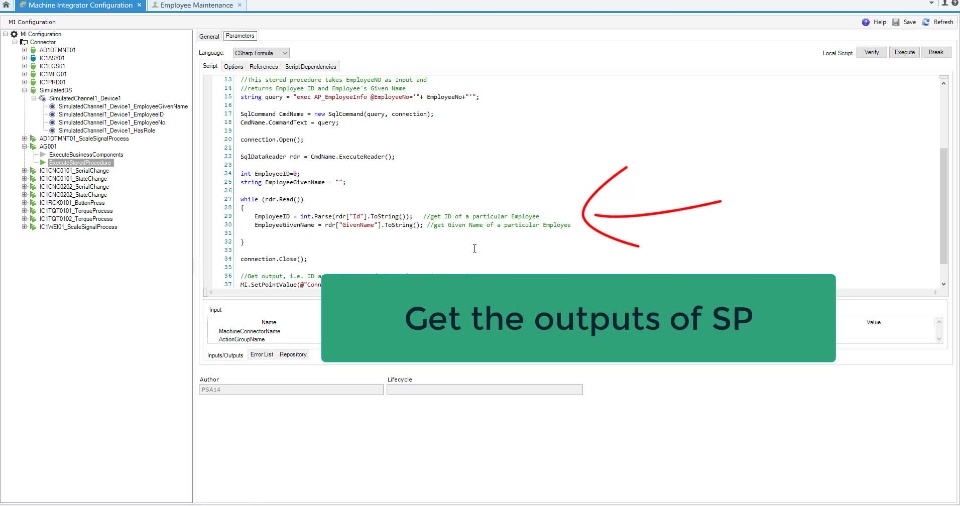

Here’s the 2nd post of the series, #HowToWithAprisoMI,  which is - “Execution of Stored Procedure via MI Script”.
As part of this post, we are going to do the following things:
  1. Execution of a custom Stored Procedure – “AP_EmployeeInfo” via MI Script
    • This Stored Procedure takes “Employee No” as an input
    • And returns Employee’s “ID” and “Given Name” against the provided Emp. No.
  2. “EmployeeNo” to the above SP will be passed as a user input
    • In this case, we will provide it from an OPC client
  3. Eventually, we will set the outputs of the SP to OPC tags
    • Outputs are: Employee ID and Employee’s Given Name
Please see the attached video for more information.
