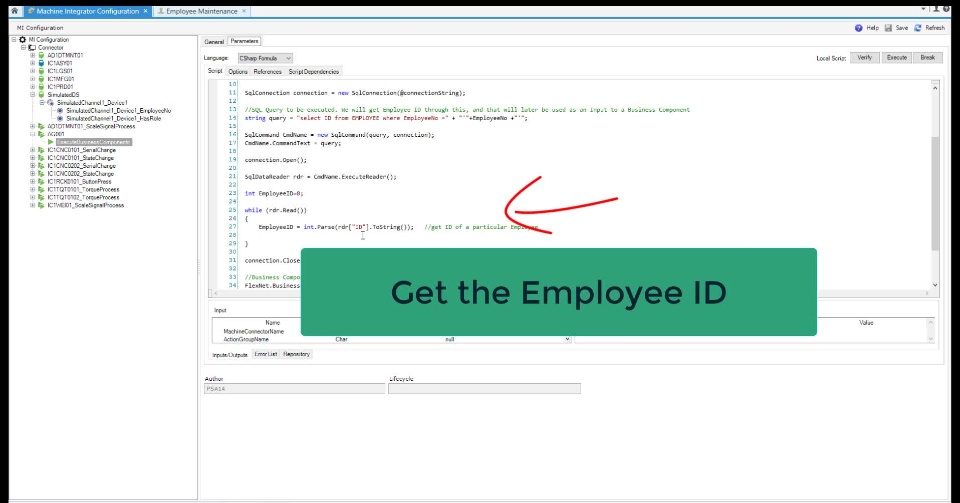

As part of the 1st post i.e. BC execution via MI Script, we are going to do the following:
- Execution of BC – “CheckEmployeeRole” via MI Script
- This BC has 2 inputs, EmployeeID and Role
- We will get “EmployeeID” by querying the “Employee” table in MI Script itself
- And the “Role” field will be passed as a hard coded value (“Production Supervisor” in this case)
- “EmployeeNo” to the above query (in the “where” clause) will be passed as a user input
- In this case, we will provide it from an OPC client
- Eventually, we will set the output of the BC to an OPC tag
- “HasRole” tag value, 0 or 1, will tell us whether the user has the specified role or not
Please see the attached video against the 1st post.
