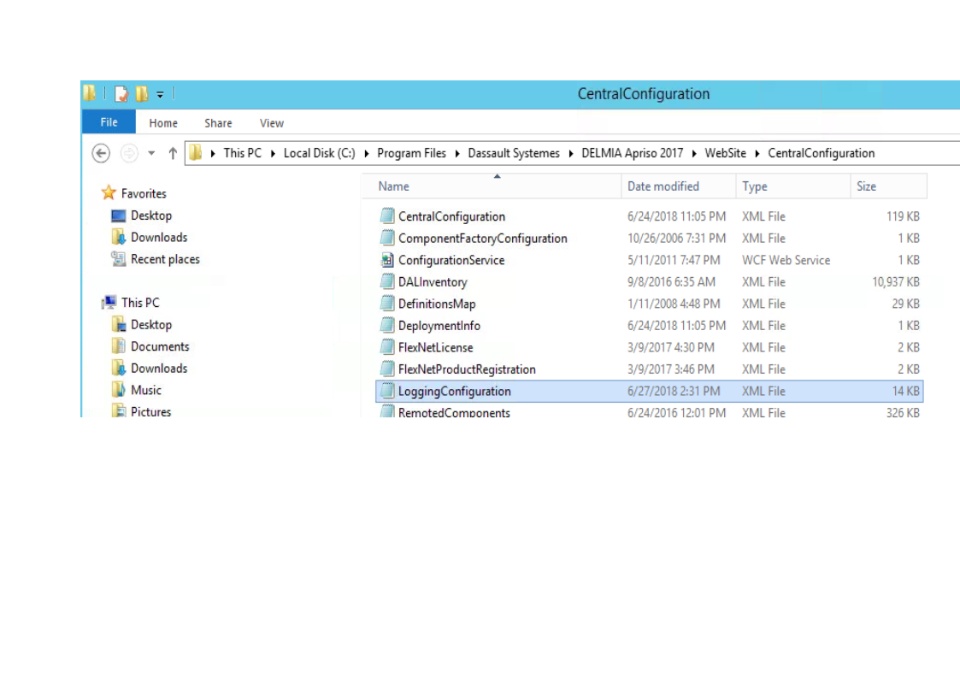

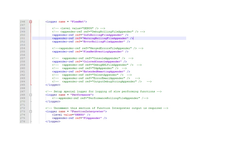

The logging configuration file is located here:
You can switch on and off different logging levels by commenting/un-commenting html in section.You can see the line 250 has the InfoRolling log uncommented, and these logs are shown now.You don’t need to restart any services to see the change. Just save the file.
