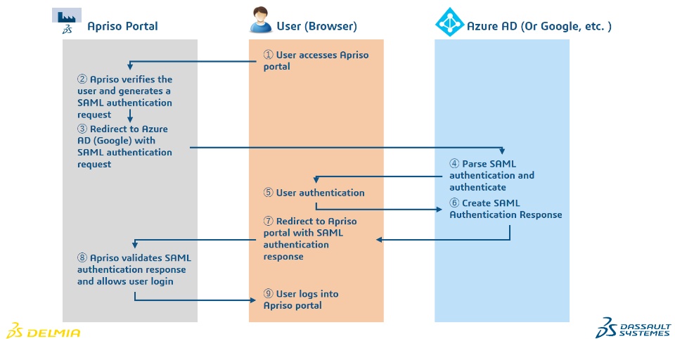

Following is the user authentication flow by SAML in case of direct integration with DELMIA Apriso:
We spent a little bit of time to develop a custom user authentication module and added it to Apriso for demo purpose. Obviously the implementation will be more complex in a real project context, but the technic required will be largely the same.

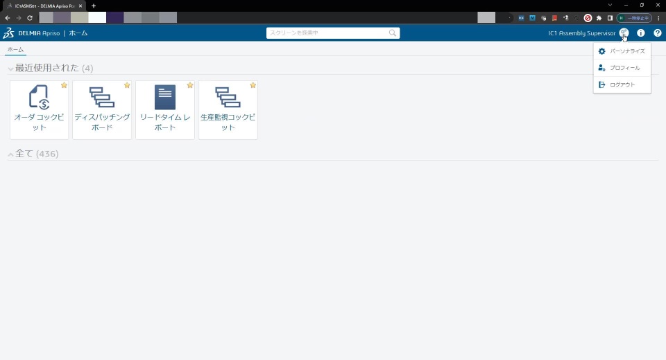

Flowing is a demo video to show you the final result of the demo configuration:
