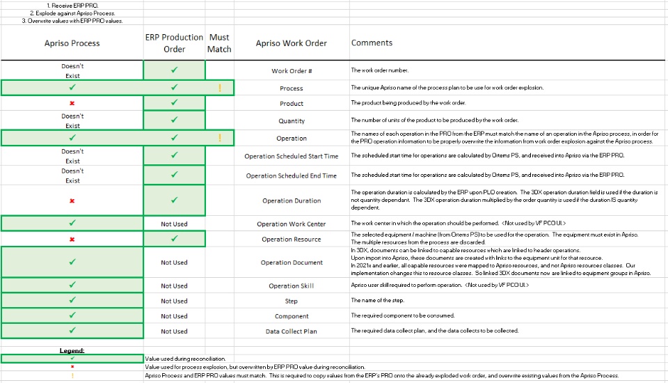

In our DCTF Work Order Creation (WOC) and Work Order Creation in Fabrication (WOC-F) scenarios, the process to create a work order in Apriso is as follows:
- Receive production order from ERP.
- Explode work order in Apriso against process plan specified by the ERP production order.
- Overwrite process plan information with ERP production order information, where applicable.
The following chart, specific to our WOC-F scenario, outlines the source of the information per element in the Apriso work order.
