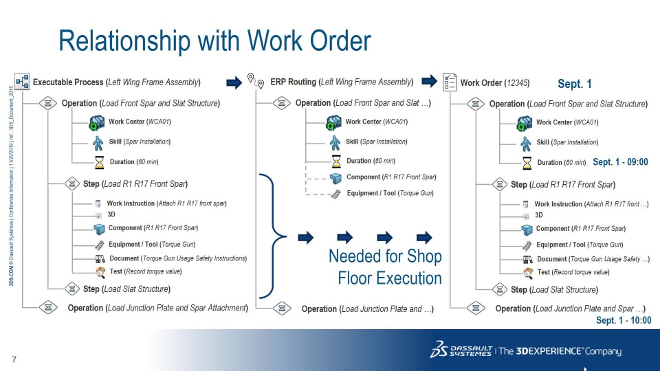

The following video defines how a Process Plan fits into the big picture for a complex assembly manufacturer.  It articulates the relationship between the 3DExperience Workplan and the Manufacturing Assembly, the ERP Routing and the eventual ERP Production Order / Apriso Work Order which is executed on the shop floor.  It also reviews the content of the Process Plan.
The 2nd half of the video reviews the impact of modeling decisions, such as the target duration of an operation, on many manufacturing business domains.
Complex Assembly Manufacturing is the type of manufacturing where takt times are long (sometimes days), and many people often work simultaneously on different jobs by making, or assembling, the same complex end item. Common product examples of this are planes, train cars, boats, and large industrial equipment.
