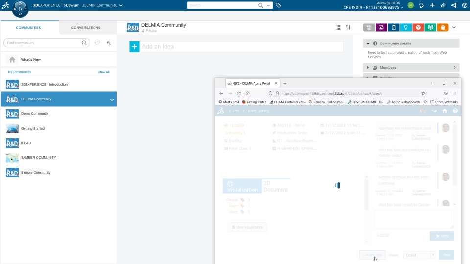

From Apriso, we can create 3DSWYM Posts in 3DEXPERIENCE Platform to enable sharing of shop floor records, alerts, defects, issues, etc. to a wider team. This enables the wider community to not only see the reasons for the issues/ or corrective actions linked to them, but also hold active discussions on the shop floor activities taking place.
In the below video, you will see a 3DSWYM post being created on 3DEXPERIENCE platform from Apriso screen.

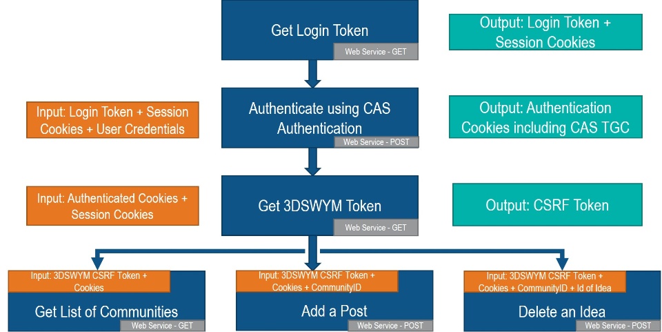

There are set of 3DSWYM APIs which can be invoked by any external client to create/edit 3DSWYM content. To access any 3DSWYM web service, we will need to follow the below generic steps:
Once we have the 3DSWYM CSRF Token – after calling the 3DSWYM authentication web service of the correct tenant - we can then call any available API of 3DSWYM like Get List of communities, Add an Idea or Add comment in post.
