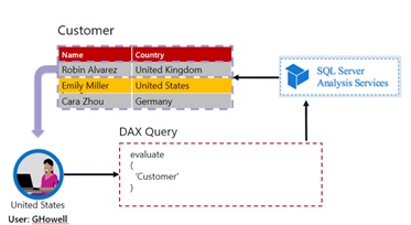

SSAS roles are database roles with assigned membership for users with granted access. The roles are passed by Apriso Portal while connecting to MPI cube.

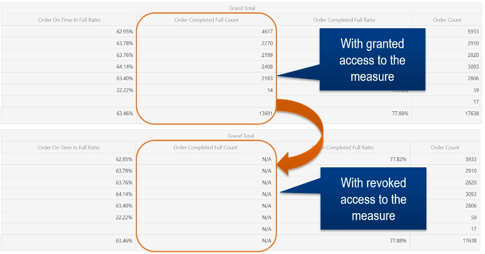

Following example is sample scenario of revoking access to "Order Completed Full Count" metric from MPI. We can see in both pivot grids, the same Apriso user is working with the data. In the second use case, one of the required roles is missing for the user in employee role configuration. Instead of seeing values corresponding to particular project (row dimension field), we now see "Not available" sign in the pivot grid column.

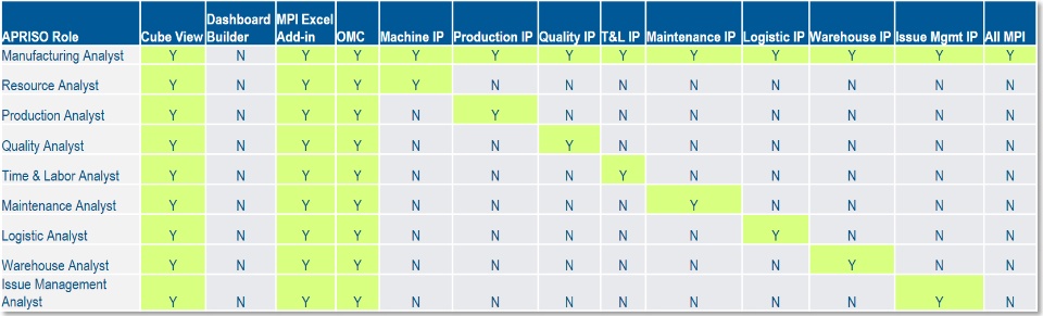

Manufacturing Analyst roles have access to content of all MPI intelligence packs. In Apriso, you can also define dedicated, separate roles that are available in MPI cube to have fine control on access to intelligence packs. Following is the table of the access rights of available roles:
