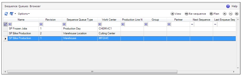

Sequence Queues Browser

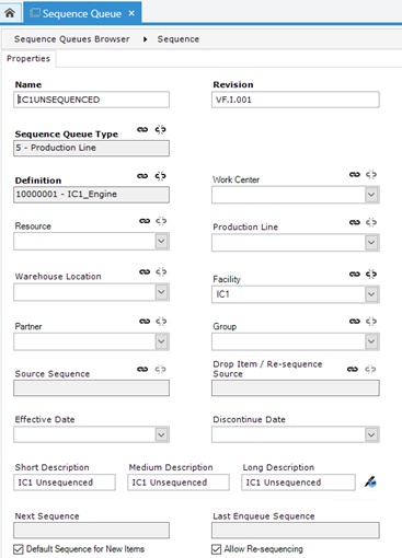

Sequence Properties
ScreenDescription
Maintenance screens for Sequence Queue objectscreating and updating Sequence Queue information and related master data

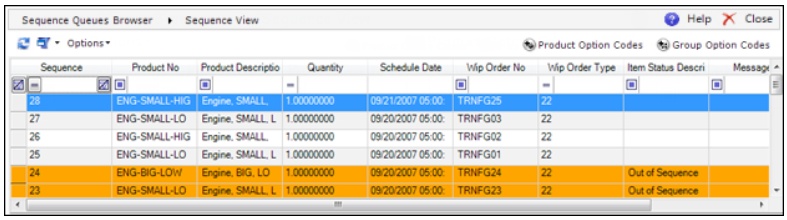

Items browser screen for a supervisorshows all of the items in the Sequence selected

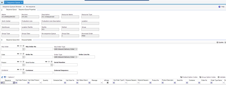

Re-sequence browser for plannerschange the selected Sequence, moving, adding, or removing items from the Sequence

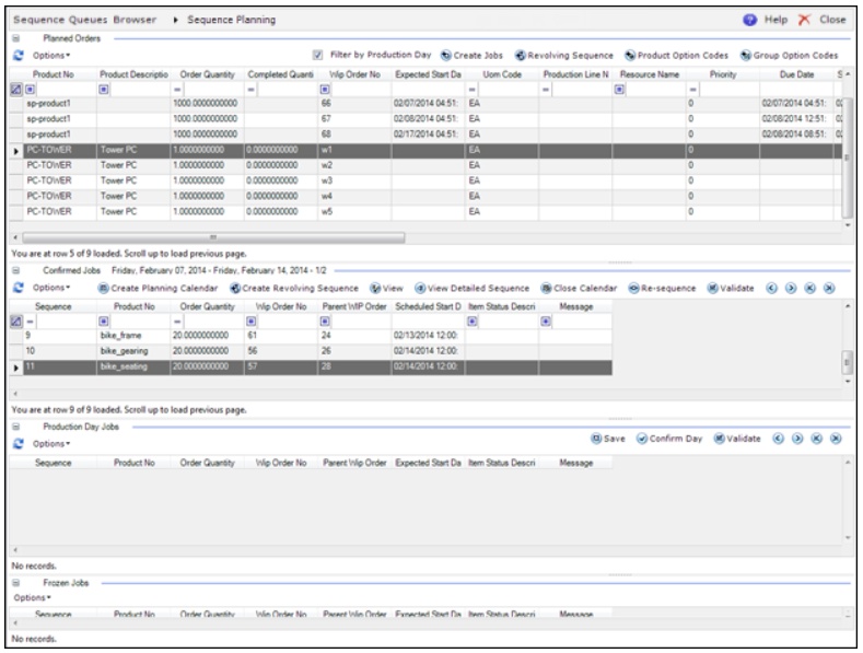

Sequence Planning screencreate production Sequences based on the daily demand from an ERP or APS (validates the sequence that the user creates against user-definable and extendable business rules)

Re-sequence browser
Additionally, how will the initial Sequence Planning be created? APRISO JIS includes a function to create a production sequence based on ERP or APS Data.  In the Sequence Planning screen, Sequencing that can satisfy Production Demand in an appropriate time frame is created.​​​​​​​
