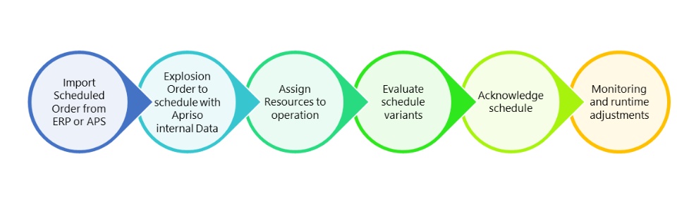

What is the general sequence for Detail Schedule management? Maybe, It will depend a lot on the system configuration and procedures within the company, but if they use ERP, APS, and MOM(MES), it will be similar to the below.
Now, I would like to look around how the APRIO Dispatching Board performs Detailed Scheduling that reflects the situation of the field by the general sequence.

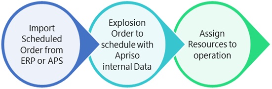

First of all, it is a Schedule Building. How does APRISO Dispatching Board reflect the Schedule created in ERP or APS?

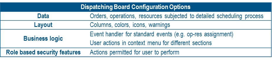

Through Workspace Classes, we define how to manage production schedules ( Manage production order by production line, production order by equipment,  or production order by line supervisor, and so on.) and what information should be displayed in the workspace.
It is possible to select items to display in main screen

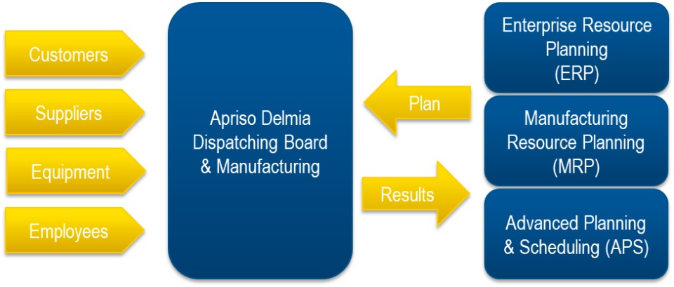

After that, the schedule to be used by the Dispatching Board is created with the actual schedule information (internal data and external data).
Internal Business Data – APRISOExternal Business Data – ERP or APS

APRISO provides to interface with other legacy system like ERP and APS

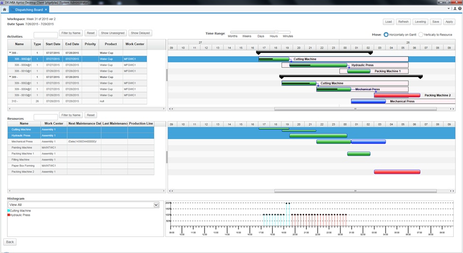

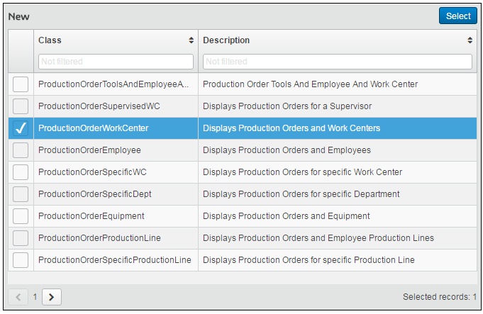

And the supervisor who manages the production creates a Workspace Instance based on Workspace Classes and adjusts the detailed schedule on the Dispatching board.
Workspace Classes

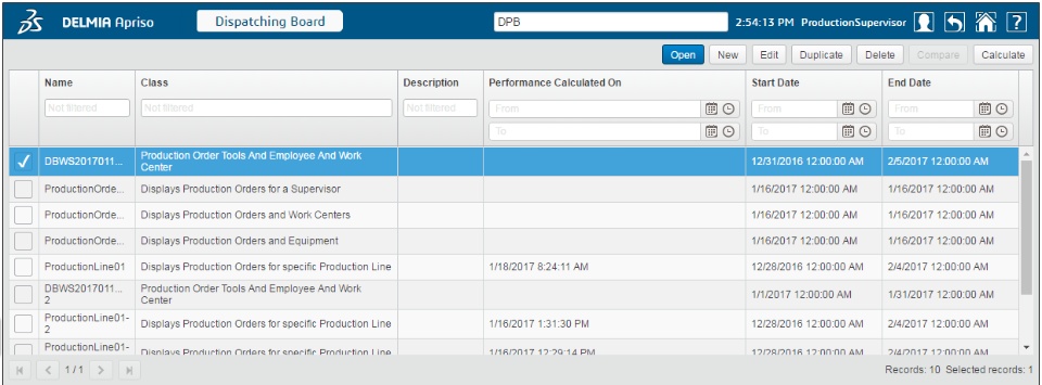

Workspace list which created based on Workspace class
Dispatching Board Main Screen
