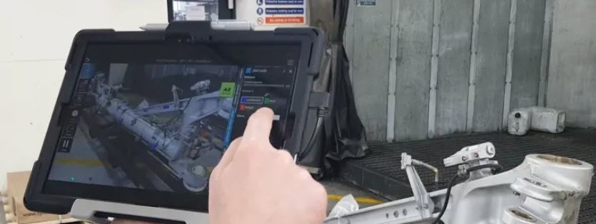

To do this, the operator is now guided by digital instructions at each step, using DELMIA’s Augmented Experience assisted inspection capability. Overlaying 3D models for critical and complex tasks allows adaptation to the operator’s level of expertise through a simplified expression of assembly or inspection operations. The level of assistance is more or less detailed depending on the experience of the operator, from beginner to expert, thereby optimizing the learning curve while improving versatility in the repair shop, a key factor of competitiveness and flexibility in MRO.

In this context, the use of digital compliance control instructions also brings a significant improvement. As assembly progresses, the results of the operations of each task up to the measurement or tightening torque reading from connected tools are systematically recorded.
During preliminary inspection or final inspection tasks, pictures taken with the camera with associated inspector comments are automatically exported to a reporting function allowing the final report to be personalized according to the repaired product and client.
DELMIA Augmented Experience introduces effective digital traceability at each key stage. The digital information, associated with the digital model of the product concerned is consolidated in a database to be used subsequently for the purposes of analyzing the in-service behavior of the products.
