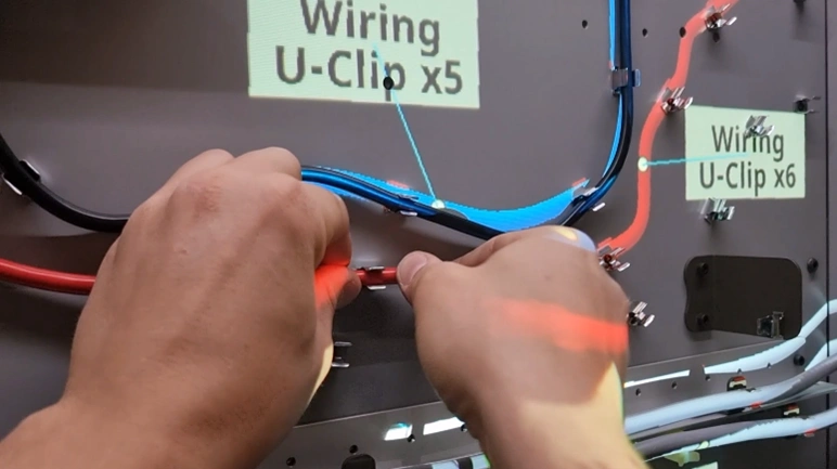

Augmented Reality (AR) handles the live side of the same problem. Instead of a paper work instruction, the operator sees 3D guidance overlaid directly on the physical components, stepped through the sequence, with errors caught as they happen. DELMIA’s Augmented Experience does precisely this, projecting validated work instructions onto the real assembly so what gets built matches what was designed, with no translation loss in between. In the high-tech industry, this applies specifically to the assembly and quality inspection of semiconductor manufacturing equipment where the scale and access complexity make AR guidance genuinely useful.
