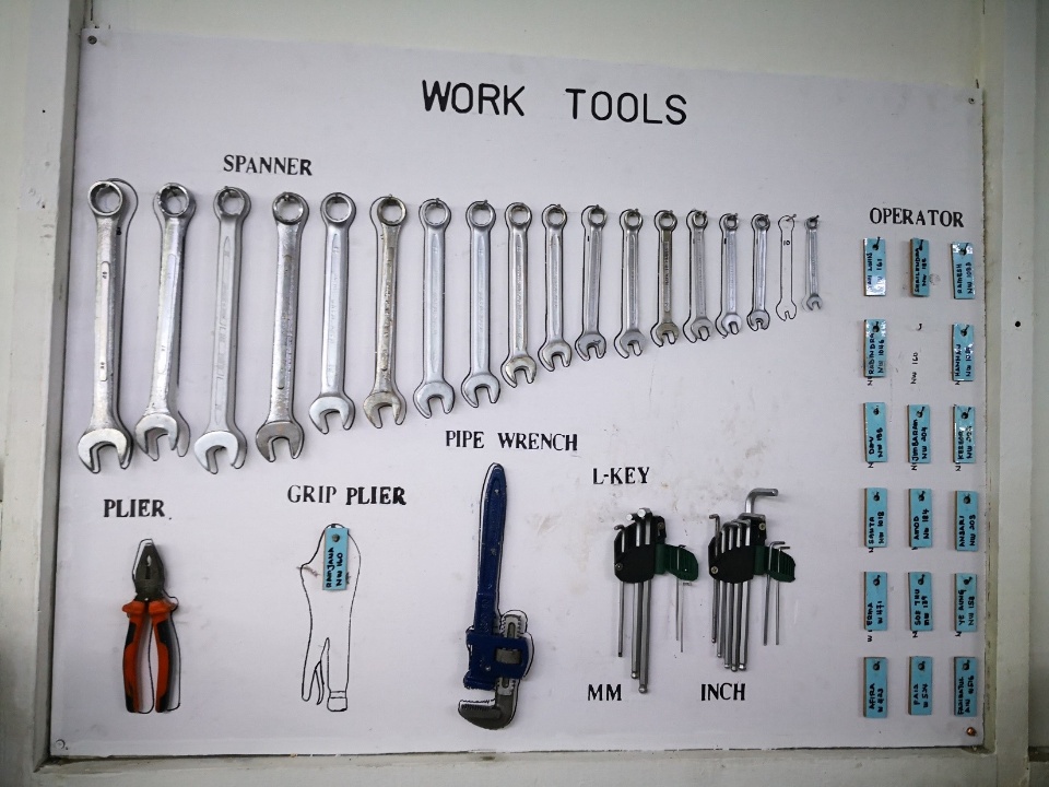

Last segment we started with Sort, the activity of deciding what’s important to have around.  The next step is to define an order to develop & maintain consistency. It’s not very lean to waste time & movement looking for the things you should have nearby.  For many shopfloor work centers this may be having shadow boards or tool trays with custom cutout areas for the specific tools.  I really like the board below.  It’s got a system to see who “checked-out” the tool so you know where to look.  Except for that pesky 10mm that always seems to be missing :-)
