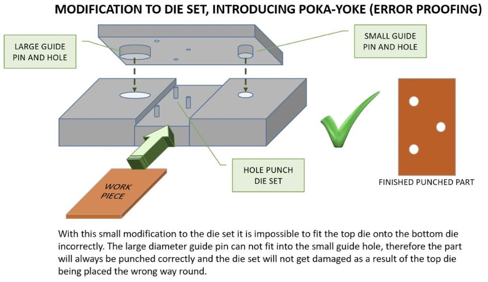

Mistake proofing, or its Japanese equivalent poka-yoke (pronounced PO-ka yo-KAY), is the use of any automatic device or method that either makes it impossible for an error to occur or makes the error immediately obvious once it has occurred.

  1. Obtain or create a flow-chat of the process. Review each step, thinking about where and when human errors are likely to occur.
  2. For each potential error, work back through the process to find its source.
  3. For each error, think of potential ways to make it impossible for the error to occur. Consider:
    • Elimination: eliminating the step that causes the error.
    • Replacement: replacing the step with an error-proof one.
    • Facilitation: making the correct action far easier than the error.
  4. If you cannot make it impossible for the error to occur, think of ways to detect the error and minimize its effects. Consider inspection methods, setting functions, and regulatory functions expanded on below.
  5. Choose the best mistake-proofing method or device for each error. Test it, then implement it. Three kinds of inspection methods provide rapid feedback:
