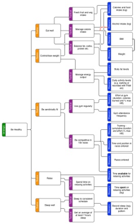

Then, for the “Relevant” aspect, my advice is to use the KPI trees methodology. There are lot of information about KPI trees on web and i am confident you will find the ones you need, but in few words:
KPI trees methodology is a visual representation of the link between KPIs, from the top company ones (financial KPIs) to the local/team level (operational KPIs). It allows to identify the missing or not relevant ones in the current organization and to build, with the team the ones that will give sense and motivation to people.
