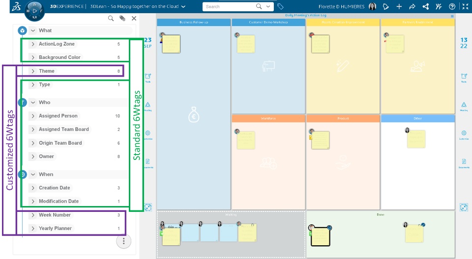

Go in your Team Board's action log, and click on the 6Wtags. Here, you see all the tags = Standards one + the one you created using action log config file.

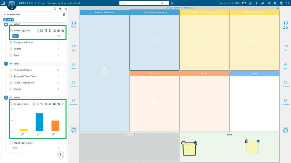

Now, according to what I want to know, I select a specific tag.
I want to know how much action I closed per year : I select "done" Action log zone and I chose the chart presentation in Creation date.
I precise that to get such datas, I didn't delete my actions from "done" area since more than a year.

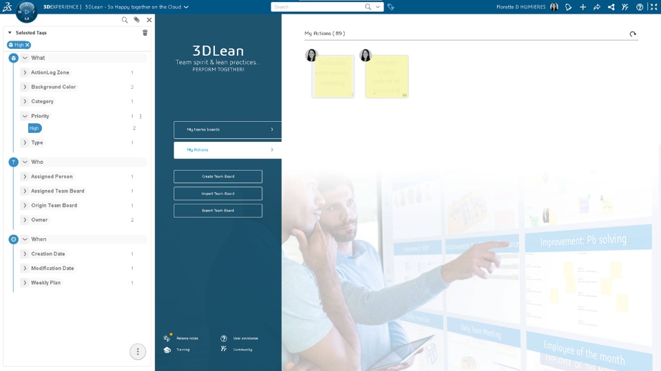

As a member of several teams, there are a lot of actions I am responsible of. I would like to sort it.
I chose to filter by priority to deal with urgent actions : on 83 actions, only 2 remain :

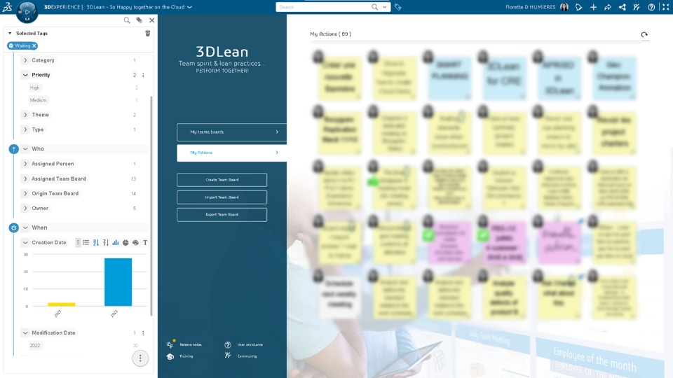

I can rather prefer to see which action are waiting since long time. I then select "waiting" zone and a display with a chart the actions creation date :
I can then select "2021" and concentrate my efforts on those 2 actions.
