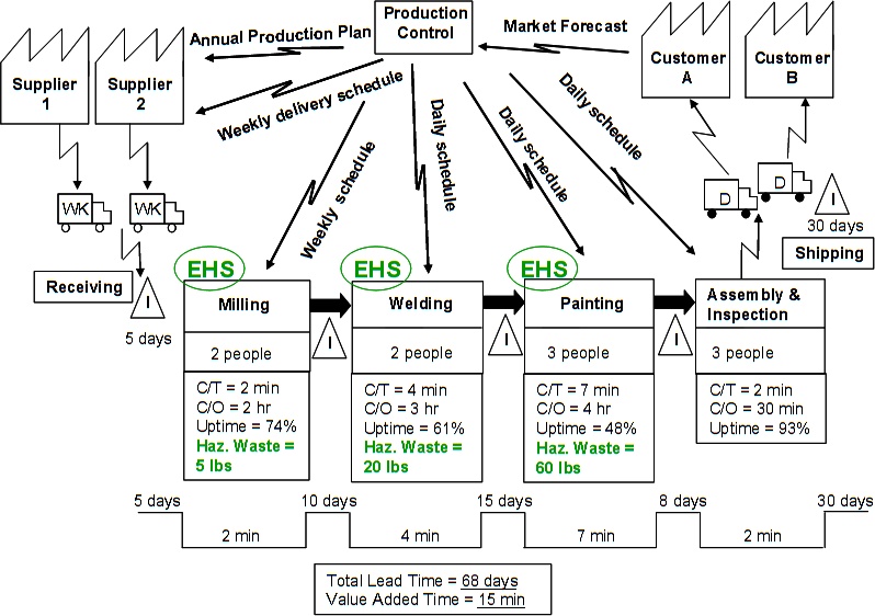

There are several tools and the one I prefer is the MIFA. The Material & Information Flow Analysis (MIFA) is an analytical tool that reveals how business management actually works and provides a picture that everyone (Management, Manufacturing, Industrialization, Supply Chain , Quality…) can understand.
The picture is the Material & Information Flow Diagram (MIFD). Whatever the perimeter, the MIFD is the starting point for everyone concerned to define the As Is and the To Be situation.
The MIFD drawing will be collaborative, as you will ask all stockholder and users to describe and to draw with you the current process. You will create it, process per process and aggregate all in a global diagram.
