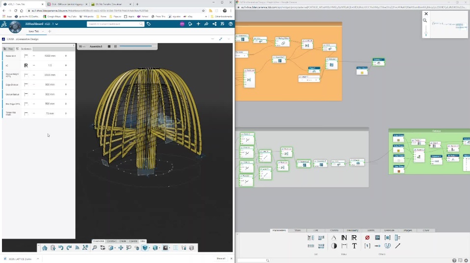

As a first Test in xGD 2020 I developed this graph for a small pavilion we are designing at AR-MA for a competition we recently won. It was first developed in Grasshopper and used as an exercise to begin to understand xGD nodes and their applications.
