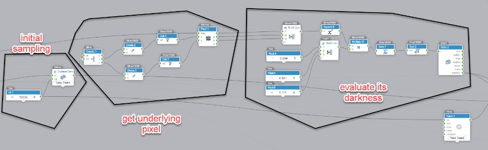

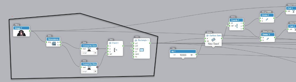

1 Import the picture and link a surface to it
  • basically, I made a rectangle where 1sqmm = 1 pixel. no scaling to keep it simple

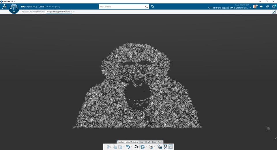

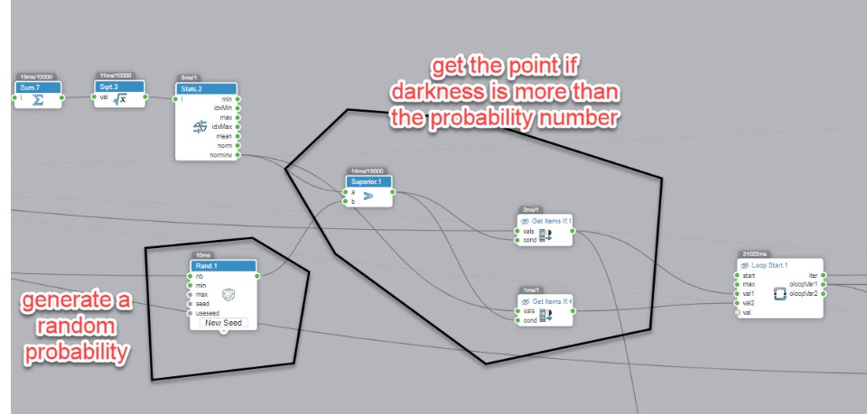

2 Generating a random sampling of points on dark zones
my intention is to have a sampling of points which looks random while more concentrated on dark area!
If you place a point where darkness is more than "0.5", in this case you get aresult which looks good but then you completely remove bright area. it is like a desert zone, then you miss the "stippling effect". you need to stipple bright area as well, but not so much
The video of youtube explains how to place point if the pixel darkness is more than a randomly chosen probability. as the darkness value is closer to 0 and brightness to 1, the probability to get a point on dark pixel is higher than on bright one. But, you can still get point on completely bright pixel.

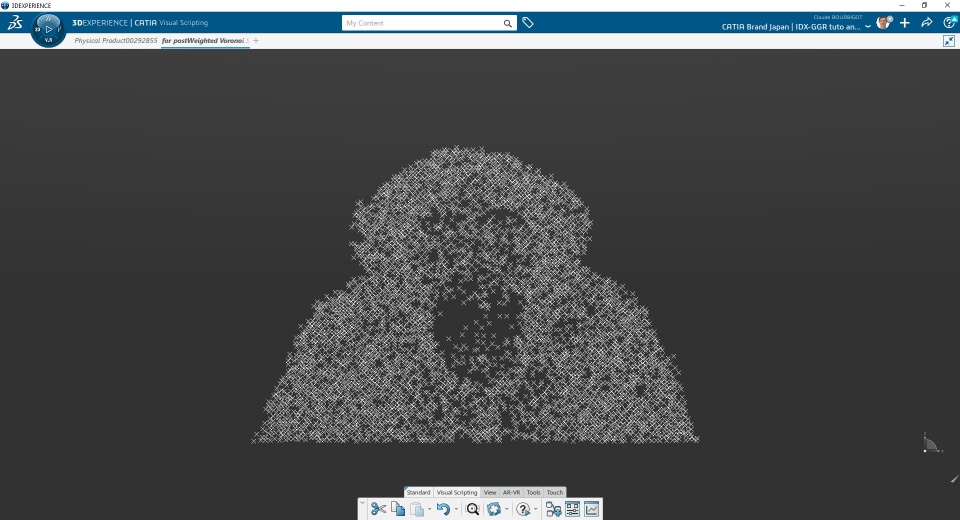

initial point sampling
points with a darkness above 0.5
points with a darkness above a random probability
logic
  1. sample the surface with points
  2. evaluate the brightness of its corresponding pixel
  3. generate random probability numbers, as many as the sampling number of points
  4. get the point if the rescaled darkness (1-rescaled brightness) is above its random number

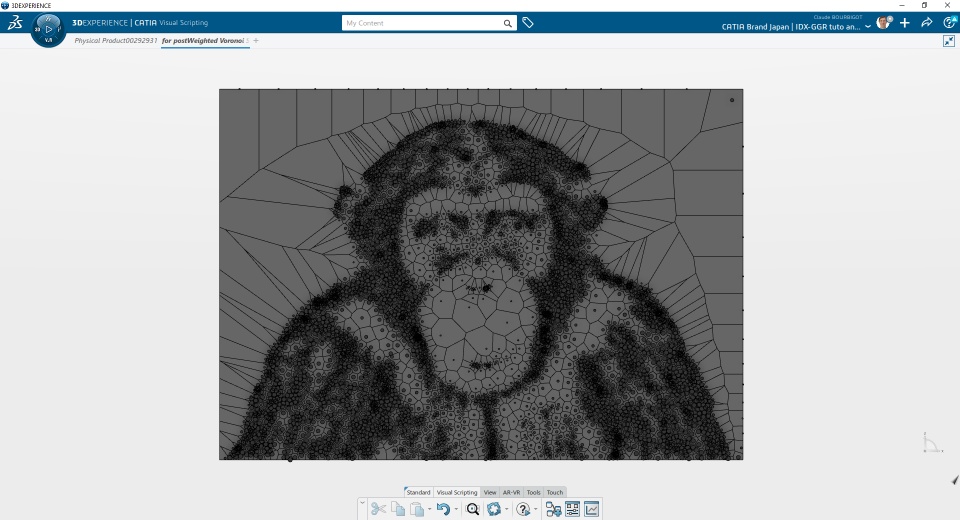

3 Weighted Voronoi
the Voronoi you get with the above distribution of points is good. However, it is missing a certain regularity within randomness that makes it human and give the stippling effect. the purpose is to emphasize the contrast (bright/dark) while getting a more regular distribution of points!!!
To do that, we relax the Voronoi following the same logic as Lloyd Algorithm, which is well explained in the video. At least, I could understand better than with below wikipedia link
 https://en.wikipedia.org/wiki/Lloyd%27s_algorithm

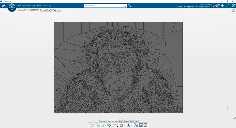

If we followed Lloyd relaxation, in the end, you get an even distribution! it blurs the image. So to get the intended result, I weighted the Voronoi cell's vertexes with underlying pixel darkness values. weighting with all the Voronoi cell points is impossible because of computing time. but just the cell vertex gave results I found OK.
the logic is loop below
  • create the Voronoi cells out of the point distribution
    • the points are the cell's barycenters, the centroids
  • calculate another barycenters of the cells by applying a darkness weight to the cell's vertices
  • move the centroids of the cell towards the weighted barycenter
  • use the moved centroids as input for next loop
it takes few tens of minutes 30mn 1h depending on my tests. in youtube video it looks instant. I wish relaxation could be faster. but we are on a geometrical modeler while in youtube they are only on pixels.
  • then create visualize the point with circles or sphere and link radius to the weigthed centroid average brigthness of the zone

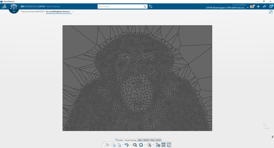

here is some results
Voronoi 50 iterations with translation of 0.2 distance of the weighted centroid and the no-weight centroid

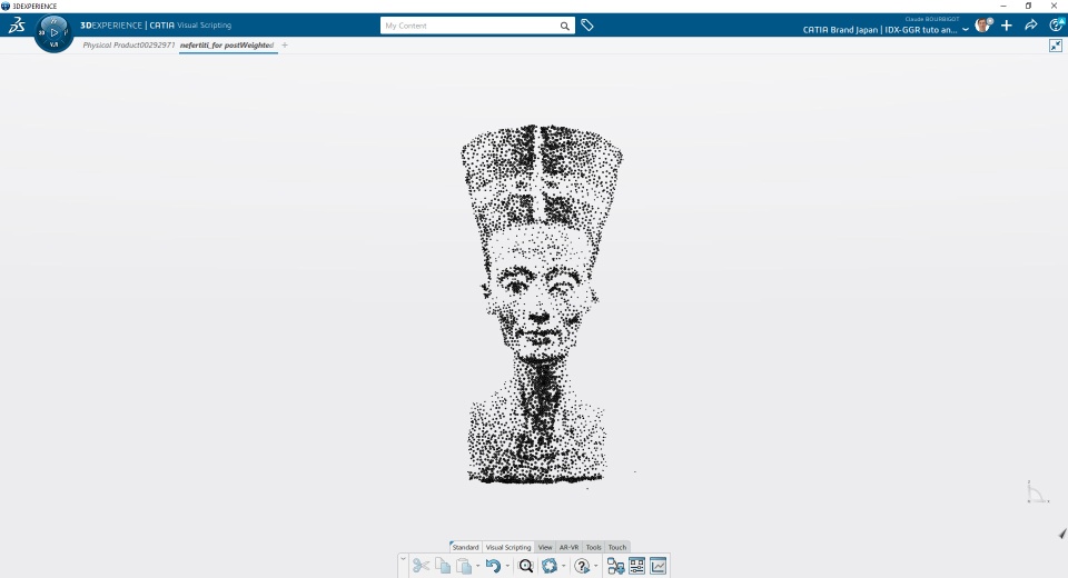

with central points (circles with radius related to darkness)
with central points (circles with radius related to darkness) - no voronoi
It worked well because dark zones of the Monkey are really dark, therefore getting initial points are OK

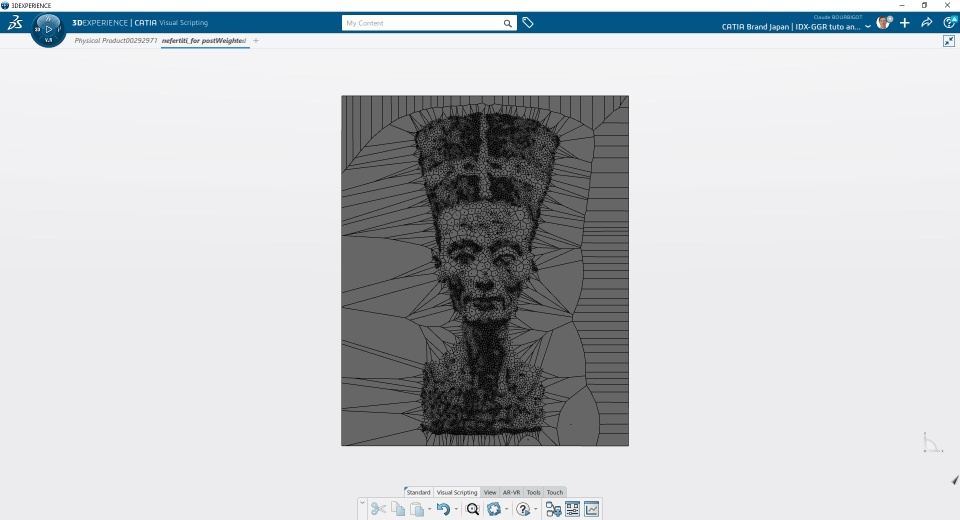

below with Nefertiti, I had to do 20000 initial points to get enough for the Voronoi. then, I just did 10 iteration for the relaxation otherwise, she looked like a mummy.
