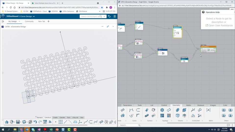

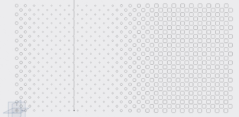

Here is a tutorial on how to create a basic Quad grid with variation.
modeling workflow is as follow:

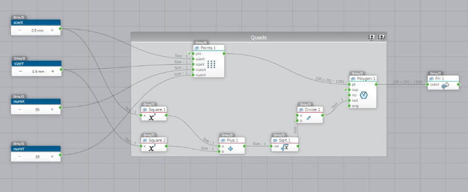

1. create Quad grid (I use a user defined feature which is in the Quad template.zip)
you need to import the file and create a library in order to reuse it
2 create chessboard grid using Odd/Even + Mix
3 create the centers of the chessboard quads
4 create a attractor curve
5 set the attractor curve to the chessboard quads's centers
6 normalize the value of the impacted center translation
7 scale the chessboard quads by the above value
8 if necessary, transpose the quad grid in order to have proper value for the attraction
Template modelization for the Quads user defined feature
I think it is a good exercise to get started with Xgen modeling logic
