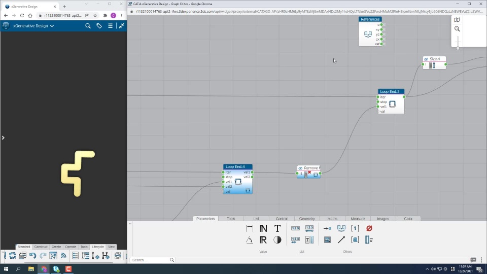

in my model F=1 G=2 +=3 -=4
1. Open the 3dxml of Arrowhead of Sierpinski in my previous Tuto
2. modify the rules (1 → 132), (2 → 142)
3. modify the angle to 90deg
final 3dxml
