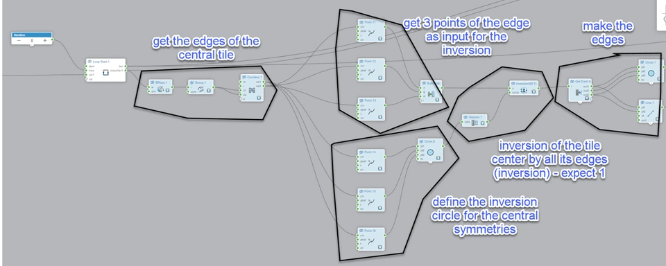

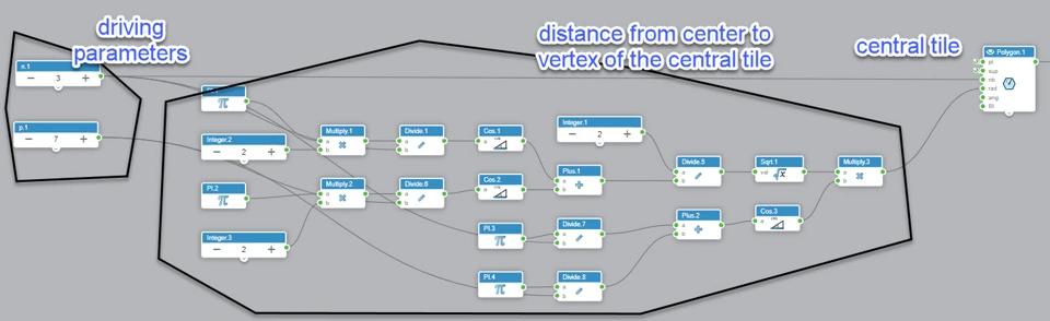

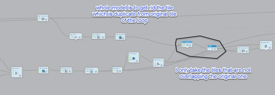

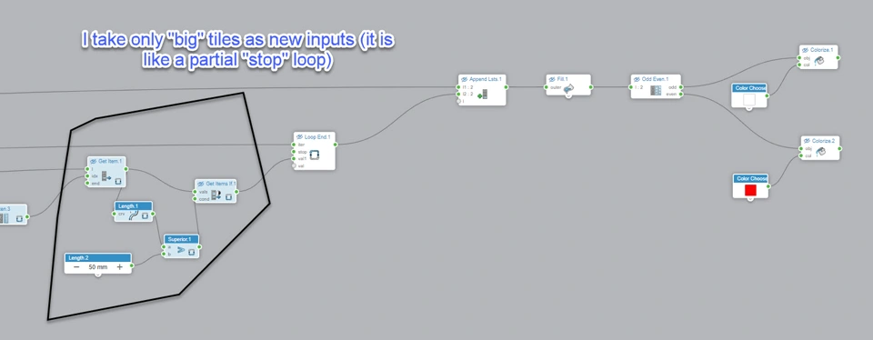

the base logic
1. create the base tile (central one). shame I did it 1 year ago and cannot crack the formula again (despite doc and chatgpt...)
2 loop
         2.1 make the inversion of the tile by all its sides
         2.2 remove from the loop the tiles that are overlapping
         2.3 stop the loop when the tile size is too small

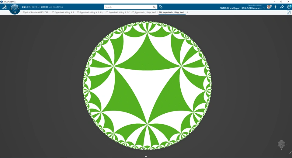

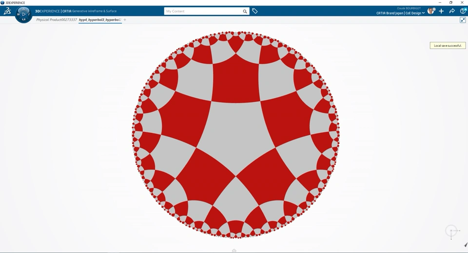

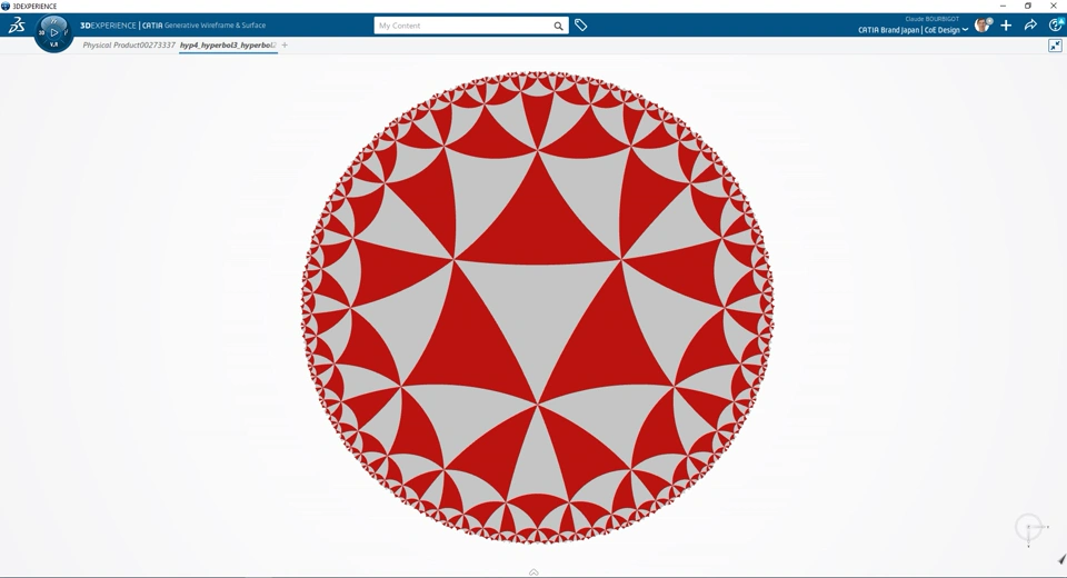

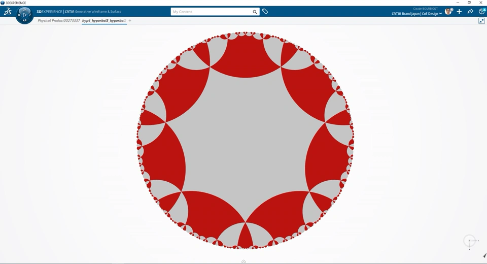

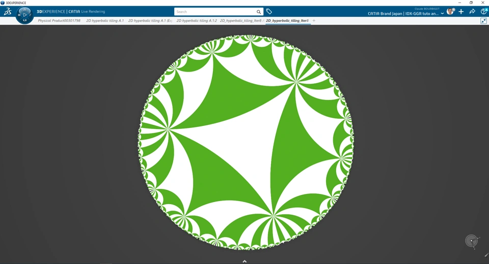

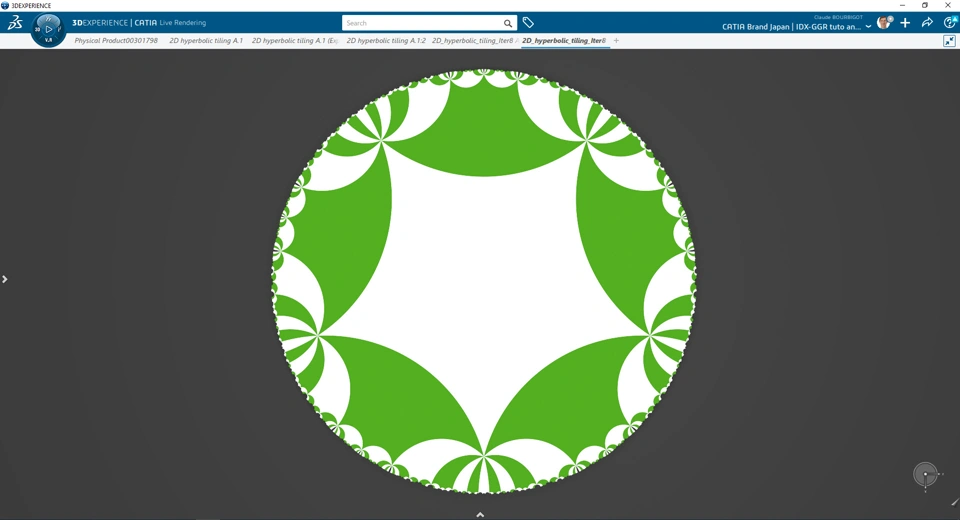

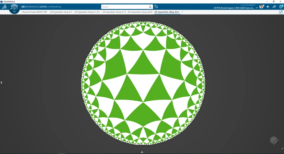

here are some pictures
3-7
5-12
3-12
