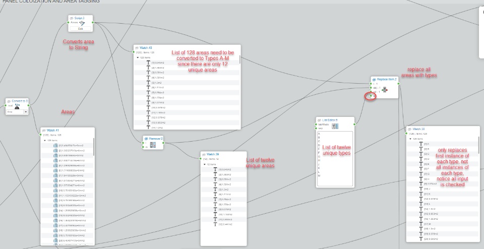

Hello, Does anyone else have any issues with the replace item node? I would like to tag a series of panels based on their size. I know geometrically that they all are one of twelve sizes, so I should be able to simply do a replace on their area for a letter to tag them. Instead of replacing the entire list the node replaces the first instance of each size. Note that I do have the dimension on the inputs set to 1, and the All input toggle to on.
