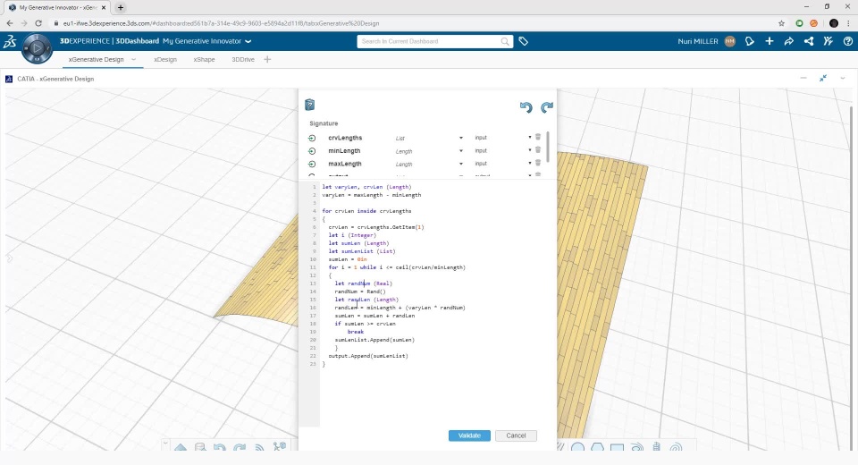

@TP , from Bergmann - Architects Engineers Planners​​​​​​​, was asking me yesterday about a scenario where xGenerative Design could easily produce randomized planks for a wood design they are working on. A randomized panel generation could obviously have many other applications than just wood planking but this is the current need.
I decided to use a Script Node in order to control how the randomized lengths are generated per each input curve. The for loop has a conditional break when it exceeds the curve length so there aren't any frivolous operations. For anyone that's interested take a look at the video below and feel free to download the 3DXML.
