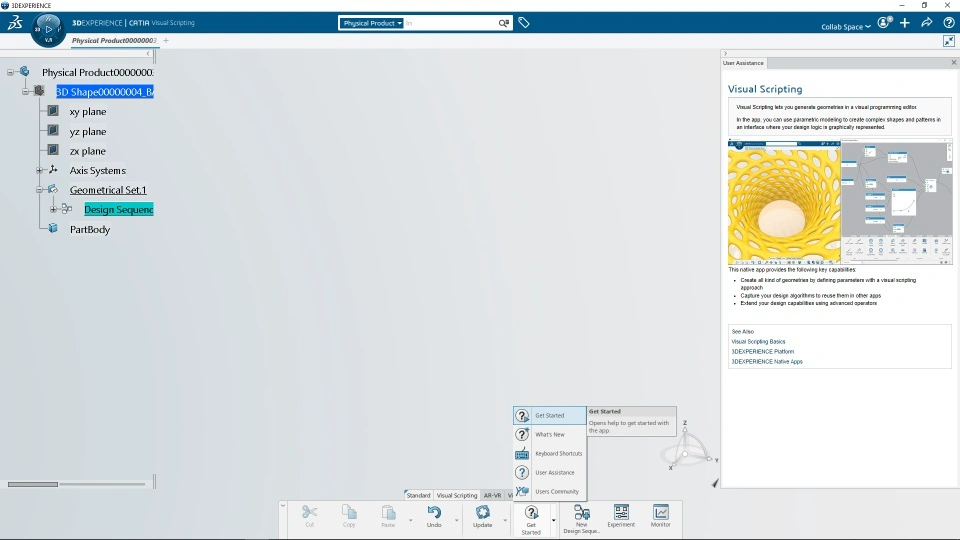

As a reminder, "What's New" and "Get Started" are directly accessible from the application / actionbar.

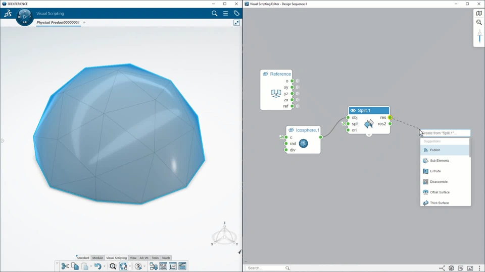

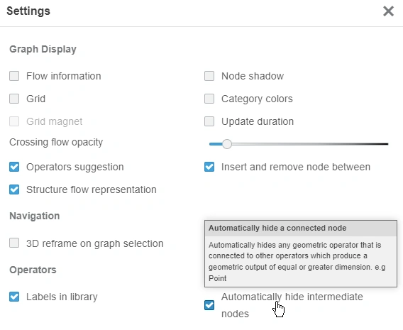

Hiding Intermediate Geometries Automatically
CATIA Visual Scripting CATIA xGenerative Design
The new option Automatically hide intermediate nodes hides an input geometry when it is used to create another geometry, provided that the output geometry has the same dimension or higher. A setting is available to deactivate this behavior (if needed).
Benefits: Improve your productivity and speed-up your design process.

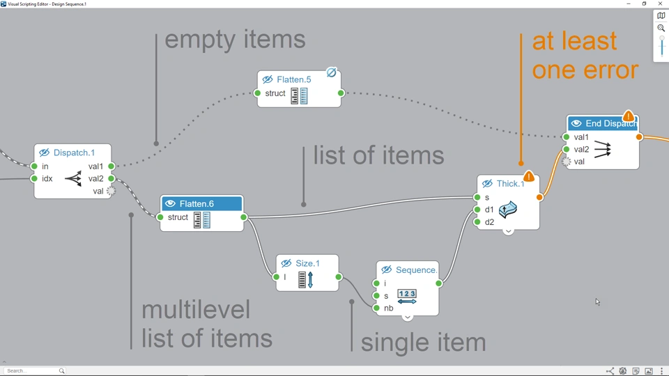

Additional information on graph dataflows and nodes
New visual styles are provided on dataflows and on graph nodes.
Benefits: Distinguish the produced results of the dataflows and the nature of errors.

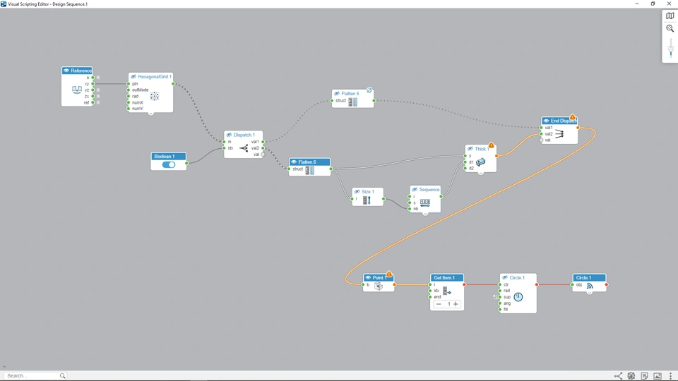

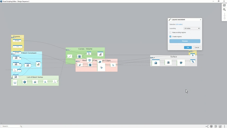

Layout Assistant : Organizing Nodes Automatically
The new Layout Assistant command lets you define some options to arrange automatically the nodes of your graph.
Benefits: Enhance the organization of your graph with smart layouting and automatic regions creation.

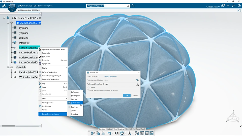

IP Protection : Managing the Viewing and Editing Rights of your Design Sequences
You can now protect your Intellectual Property by defining authorized users on a specific feature.
Benefits: Protect your design sequences intellectual property with a permission system.

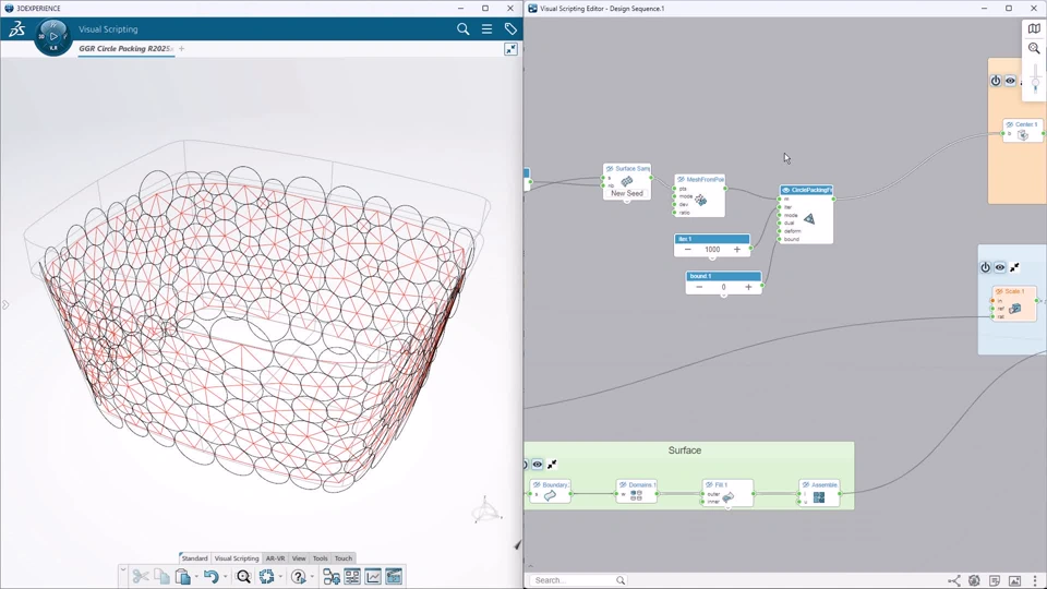

New operator: Circle Packing From Mesh
CATIA Visual Scripting CATIA xGenerative Design advanced operator
Circle Packing From Mesh generates circle or sphere packing from a triangular mesh. This operator is part of the mesh modeling advanced operators.
Benefits: Reach a new level of shape exploration.

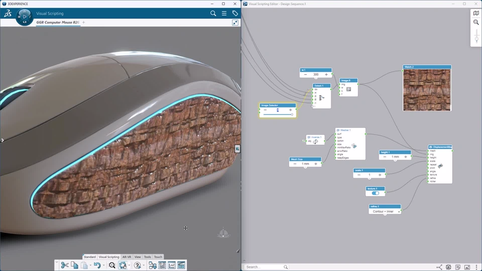

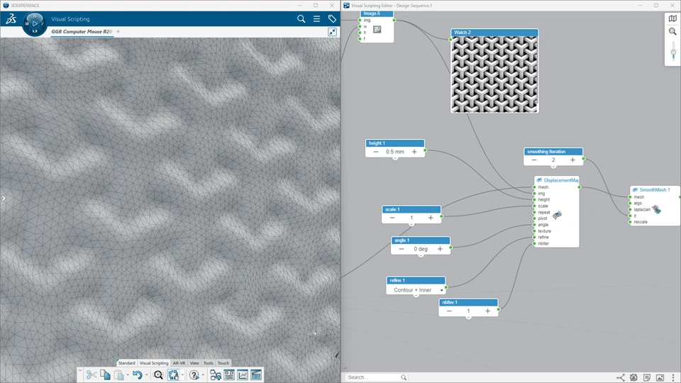

New operator : Displacement Mapping
Displacement Mapping deforms a mesh using a greyscale image as input. This operator is part of the mesh modeling advanced operators.
Benefits: Reach a new level of shape exploration. This operator can be used to generate 3D textures from 2D images.

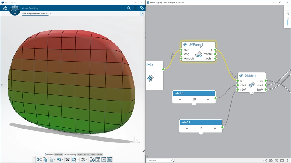

New operator: UV Parameterization
UV Parameterization uses an unwrapping technique to extend a multipatch surface by associating a specific global UV description to the open surface.
Benefits: The UV description ensures good continuity between patches for the operators that use UV parameters as input. These operators are Divide Surface, Grid UV, Hexagons With UV Parameterization, Isoparam Curve Point, Isoparam Curve Ratio, and Point on Face.

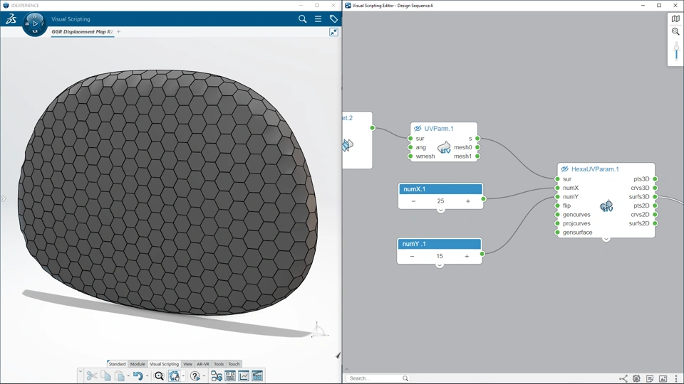

New operator: Hexagons with UV Parameterization
Hexagons with UV Parameterization creates hexagons on a surface using its UV parameterization.

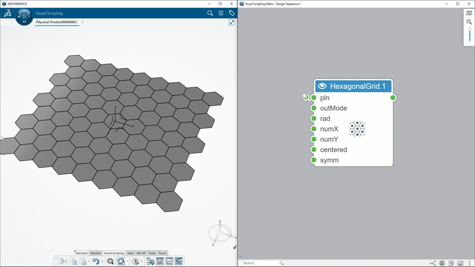

Enhanced Operators: Grid Operators
The Hexagonal Grid, Rectangular Grid, and Triangular Grid operators are enriched with new options, such as Centered Grid, Symmetric Grid, or Output Mode.
